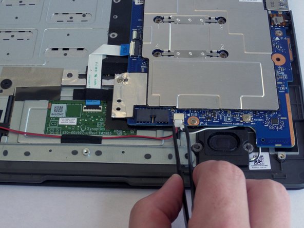

  6. Acer Aspire One Cloudbook 11 AO1-131-C7DW Speaker Replacement, Speaker: crwdns2935265:06crwdnd2935265:01crwdnd2935265:02crwdne2935265:0 Acer Aspire One Cloudbook 11 AO1-131-C7DW Speaker Replacement, Speaker: crwdns2935265:06crwdnd2935265:02crwdnd2935265:02crwdne2935265:0
    • Position the computer so the opening of the laptop faces you.
    • Unplug the white plastic connector that has red, white, and black wires using tweezers.
