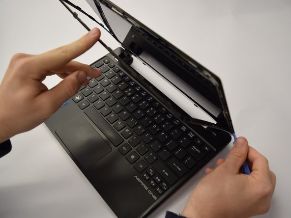

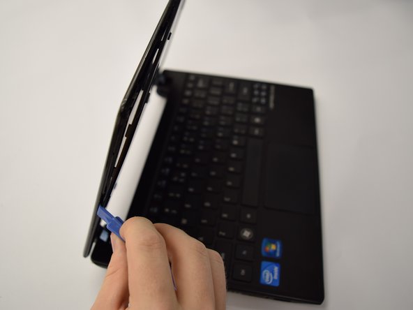

  5. Acer Aspire One AO756-2623 LCD Sceen Replacement: crwdns2935265:05crwdnd2935265:01crwdnd2935265:03crwdne2935265:0 Acer Aspire One AO756-2623 LCD Sceen Replacement: crwdns2935265:05crwdnd2935265:02crwdnd2935265:03crwdne2935265:0 Acer Aspire One AO756-2623 LCD Sceen Replacement: crwdns2935265:05crwdnd2935265:03crwdnd2935265:03crwdne2935265:0
    • Insert the spudger into the indicated crease.
    • Firmly slide spudger around the edge of the entire laptop to remove the front plate of the screen.
    • Loud cracking noises from the plastic tabs separating may occur, do not worry, they are to be expected.

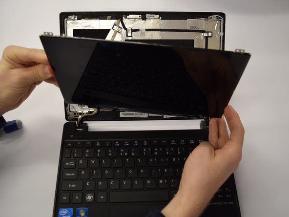

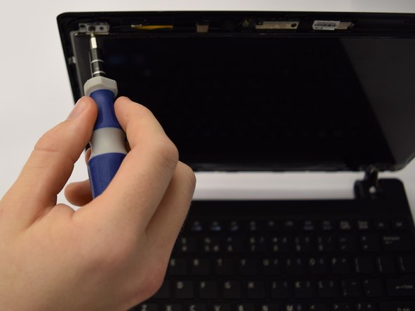

  6. Acer Aspire One AO756-2623 LCD Sceen Replacement: crwdns2935265:06crwdnd2935265:01crwdnd2935265:03crwdne2935265:0 Acer Aspire One AO756-2623 LCD Sceen Replacement: crwdns2935265:06crwdnd2935265:02crwdnd2935265:03crwdne2935265:0 Acer Aspire One AO756-2623 LCD Sceen Replacement: crwdns2935265:06crwdnd2935265:03crwdnd2935265:03crwdne2935265:0
    • Identify the four 6 mm Phillips screws that are necessary to remove the LCD screen.
    • Remove all four screws using a Phillips #0 Screwdriver.
    • Pull away the LCD screen from the back cover of the laptop without ripping the ribbon cable connecting it to the bottom of the laptop.

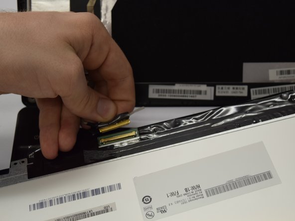

  7. Acer Aspire One AO756-2623 LCD Sceen Replacement: crwdns2935265:07crwdnd2935265:01crwdnd2935265:03crwdne2935265:0 Acer Aspire One AO756-2623 LCD Sceen Replacement: crwdns2935265:07crwdnd2935265:02crwdnd2935265:03crwdne2935265:0 Acer Aspire One AO756-2623 LCD Sceen Replacement: crwdns2935265:07crwdnd2935265:03crwdnd2935265:03crwdne2935265:0
    • Remove the tape covering the port connecting the screen to the bottom of the laptop.
    • To remove the LCD screen, gently pull the cable straight out of the screen.
    • In the first and second photos, the screen is lying face down on the keyboard.
