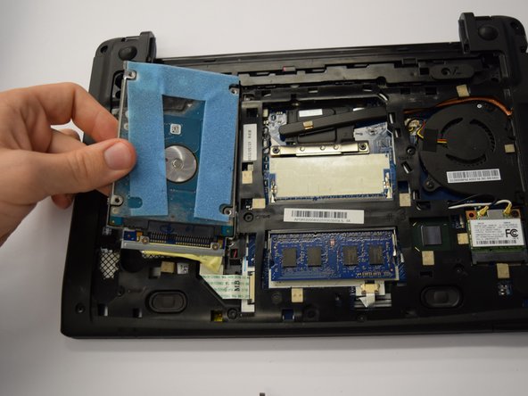

  8. Acer Aspire One AO756-2623 Hard Drive Replacement: crwdns2935265:08crwdnd2935265:01crwdnd2935265:01crwdne2935265:0
    • Remove the hard drive by pulling it straight out.
