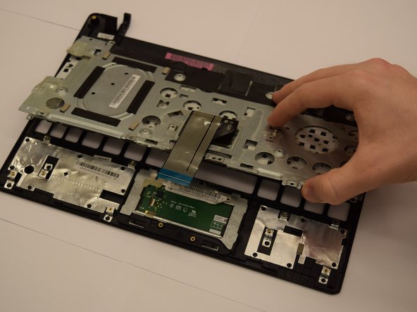

  8. Acer Aspire One AO756-2623 Fan Replacement: crwdns2935265:08crwdnd2935265:01crwdnd2935265:03crwdne2935265:0 Acer Aspire One AO756-2623 Fan Replacement: crwdns2935265:08crwdnd2935265:02crwdnd2935265:03crwdne2935265:0 Acer Aspire One AO756-2623 Fan Replacement: crwdns2935265:08crwdnd2935265:03crwdnd2935265:03crwdne2935265:0
    • Remove the green dotted ribbon cable by sliding it straight out of the clamp holding it in using a plastic spudger.
    • Locate the two tabs that are holding the larger black ribbon cable in place.
    • Remove the larger black ribbon cable by pressing in the tabs and sliding it straight out of the clamp holding it in using a plastic spudger.
    • To remove the keyboard, lift the keyboard straight away from the rest of the laptop.

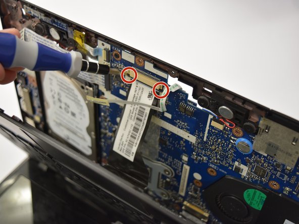

    • Locate the ten 6 mm Phillips screws that connect the keyboard to the rest of the laptop and remove them with a Phillips #0 Screwdriver.
    • Locate the four 6 mm Phillips screws hidden beneath black tape by lifting up the black tape and remove them with a Phillips #0 Screwdriver.
    • To remove keyboard from the rest of the laptop, pull keyboard straight up.

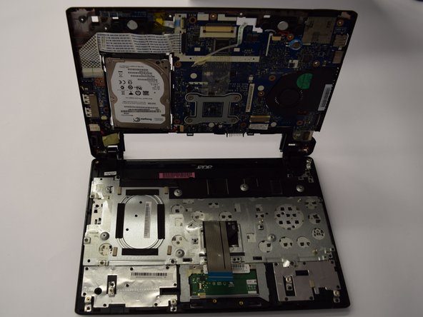

  10. Acer Aspire One AO756-2623 Fan Replacement, Fan: crwdns2935265:010crwdnd2935265:01crwdnd2935265:01crwdne2935265:0
    • Orient laptop with open screen facing you.
    • Peel back black tape.
  11. Acer Aspire One AO756-2623 Fan Replacement: crwdns2935265:011crwdnd2935265:01crwdnd2935265:02crwdne2935265:0 Acer Aspire One AO756-2623 Fan Replacement: crwdns2935265:011crwdnd2935265:02crwdnd2935265:02crwdne2935265:0
    • Orient the laptop to where the bottom of the laptop is facing upwards.
    • Locate the port that connects the fan to the laptop.
    • Use a nylon spudger to firmly pull out the cable from the port.
    • Pull the fan straight out to remove it from the rest of the laptop.
