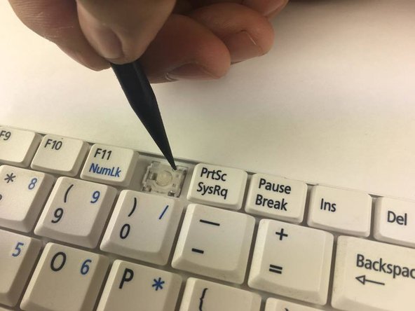

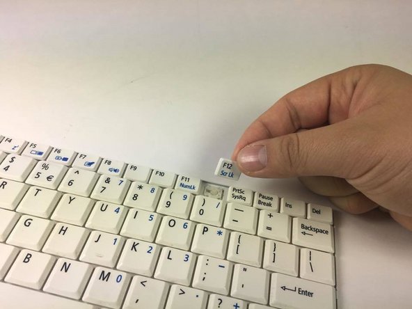

    • Using the Blue Plastic Opening Tool, remove the white plastic piece of your desired key.
    • Place the Blue Plastic Opening Tool on the right side of the individual key, then gently pull up to detach the clips underneath.
    • Remove the key from the hinges by sliding the key to the left.
  5. Acer Aspire One A150-1672 Individual Key Replacement: crwdns2935265:05crwdnd2935265:01crwdnd2935265:02crwdne2935265:0 Acer Aspire One A150-1672 Individual Key Replacement: crwdns2935265:05crwdnd2935265:02crwdnd2935265:02crwdne2935265:0
    • Two ends need to be unhooked. They are located at the top and bottom of the key on the right side.
    • Using the Spudger, push the small, clear-colored end of the hinge out of the hook.
  6. Acer Aspire One A150-1672 Individual Key Replacement: crwdns2935265:06crwdnd2935265:01crwdnd2935265:02crwdne2935265:0 Acer Aspire One A150-1672 Individual Key Replacement: crwdns2935265:06crwdnd2935265:02crwdnd2935265:02crwdne2935265:0
    • Using the Blue Plastic Opening Tool, push the plastic hinge to the left to detach the hinge after the ends on the right are detached.
    • Remove the plastic hinge by pulling the plastic hinge upwards.
