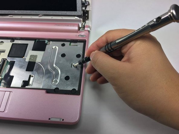

  18. Acer Aspire One A150-1672 Hinge Replacement: crwdns2935265:018crwdnd2935265:01crwdnd2935265:02crwdne2935265:0 Acer Aspire One A150-1672 Hinge Replacement: crwdns2935265:018crwdnd2935265:02crwdnd2935265:02crwdne2935265:0
    • With the Phillips #1 screwdriver, remove the six screws that connect the metal plate to the motherboard.

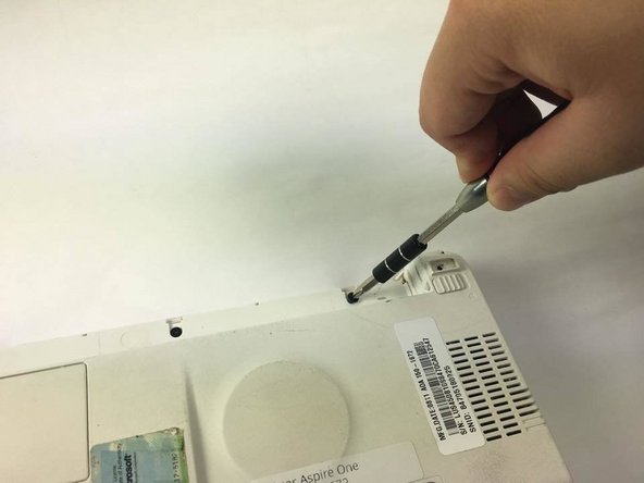

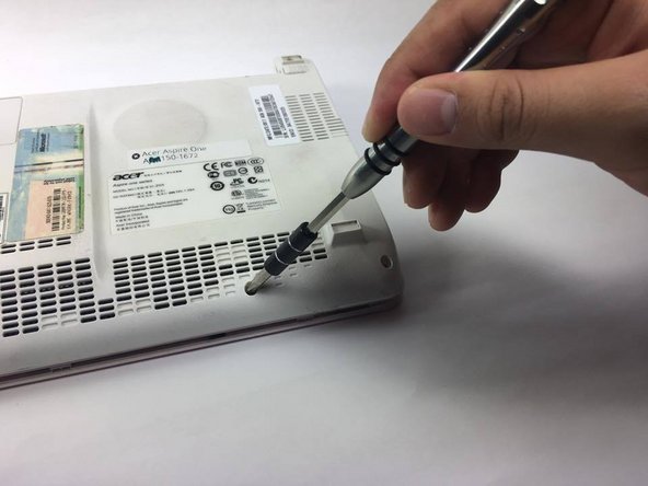

  19. Acer Aspire One A150-1672 Hinge Replacement: crwdns2935265:019crwdnd2935265:01crwdnd2935265:03crwdne2935265:0 Acer Aspire One A150-1672 Hinge Replacement: crwdns2935265:019crwdnd2935265:02crwdnd2935265:03crwdne2935265:0 Acer Aspire One A150-1672 Hinge Replacement: crwdns2935265:019crwdnd2935265:03crwdnd2935265:03crwdne2935265:0
    • To detach the bottom white casing from the netbook, a total of 8 screws must be removed using the Phillips #1 screwdriver.
    • Using the Phillips #1 screwdriver, remove three 5.2mm screws located at the bottom of the plastic casing.
    • Using the Phillips #1 screwdriver, remove three 3.78mm screws located in the middle of the casing.

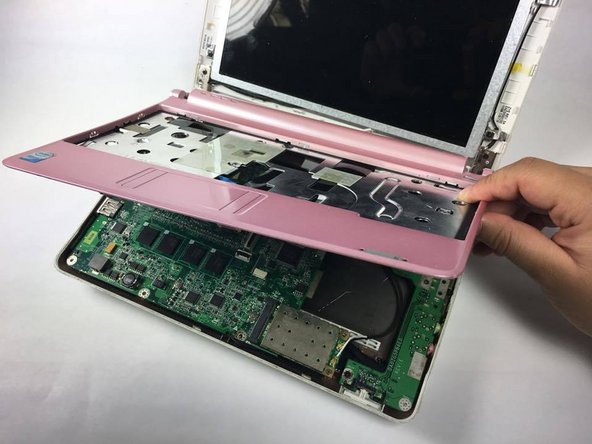

  20. Acer Aspire One A150-1672 Hinge Replacement: crwdns2935265:020crwdnd2935265:01crwdnd2935265:02crwdne2935265:0 Acer Aspire One A150-1672 Hinge Replacement: crwdns2935265:020crwdnd2935265:02crwdnd2935265:02crwdne2935265:0
    • Using the opening tool, slide it backward and forward in the gap between the pink and white casing.
    • Lift the pink casing upwards to completely remove casing from the netbook.

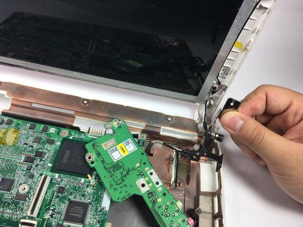

  22. Acer Aspire One A150-1672 Hinge Replacement: crwdns2935265:022crwdnd2935265:01crwdnd2935265:02crwdne2935265:0 Acer Aspire One A150-1672 Hinge Replacement: crwdns2935265:022crwdnd2935265:02crwdnd2935265:02crwdne2935265:0
    • Lift the green circuit board upwards and place it to the left hand side.
    • Unscrew two screws attaching the hinge to the bottom part of the netbook
    • Unscrew the screw attaching the hinge to the top part of the netbook
  23. Acer Aspire One A150-1672 Hinge Replacement: crwdns2935265:023crwdnd2935265:01crwdnd2935265:02crwdne2935265:0 Acer Aspire One A150-1672 Hinge Replacement: crwdns2935265:023crwdnd2935265:02crwdnd2935265:02crwdne2935265:0
    • Remove the hinge by holding on to the metal piece and pull towards yourself.
