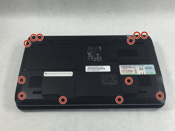

    • Close the laptop and flip it over to view the back of the laptop.
  2. Acer Aspire One 751h-1948 Fan Replacement: crwdns2935265:02crwdnd2935265:01crwdnd2935265:03crwdne2935265:0 Acer Aspire One 751h-1948 Fan Replacement: crwdns2935265:02crwdnd2935265:02crwdnd2935265:03crwdne2935265:0 Acer Aspire One 751h-1948 Fan Replacement: crwdns2935265:02crwdnd2935265:03crwdnd2935265:03crwdne2935265:0
    • Unlock the right side of the battery by sliding the battery lock to the right. Then slide the left lock to the left and remove the battery.

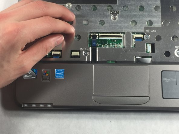

  11. Acer Aspire One 751h-1948 Fan Replacement, Front Panel: crwdns2935265:011crwdnd2935265:01crwdnd2935265:01crwdne2935265:0
    • Use the screwdriver to remove all the Phillips #00 (M2-L2.5 mm) screws shown here.
  12. Acer Aspire One 751h-1948 Fan Replacement: crwdns2935265:012crwdnd2935265:01crwdnd2935265:03crwdne2935265:0 Acer Aspire One 751h-1948 Fan Replacement: crwdns2935265:012crwdnd2935265:02crwdnd2935265:03crwdne2935265:0 Acer Aspire One 751h-1948 Fan Replacement: crwdns2935265:012crwdnd2935265:03crwdnd2935265:03crwdne2935265:0
    • Flip the laptop over and remove all the Phillips #0 (M2-L5 mm) screws under the keyboard.
    • Remove all the Phillips #0 (M2-L2.5 mm) screws
  13. Acer Aspire One 751h-1948 Fan Replacement: crwdns2935265:013crwdnd2935265:01crwdnd2935265:02crwdne2935265:0 Acer Aspire One 751h-1948 Fan Replacement: crwdns2935265:013crwdnd2935265:02crwdnd2935265:02crwdne2935265:0
    • Lift the small black clip and remove the ribbon cable before proceeding.

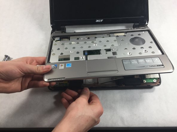

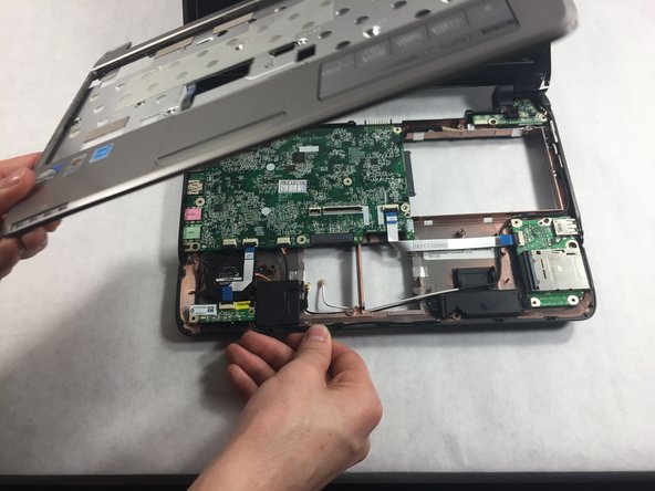

  14. Acer Aspire One 751h-1948 Fan Replacement: crwdns2935265:014crwdnd2935265:01crwdnd2935265:03crwdne2935265:0 Acer Aspire One 751h-1948 Fan Replacement: crwdns2935265:014crwdnd2935265:02crwdnd2935265:03crwdne2935265:0 Acer Aspire One 751h-1948 Fan Replacement: crwdns2935265:014crwdnd2935265:03crwdnd2935265:03crwdne2935265:0
    • Separate the front panel from the back panel, by sliding your thumb nail between them.

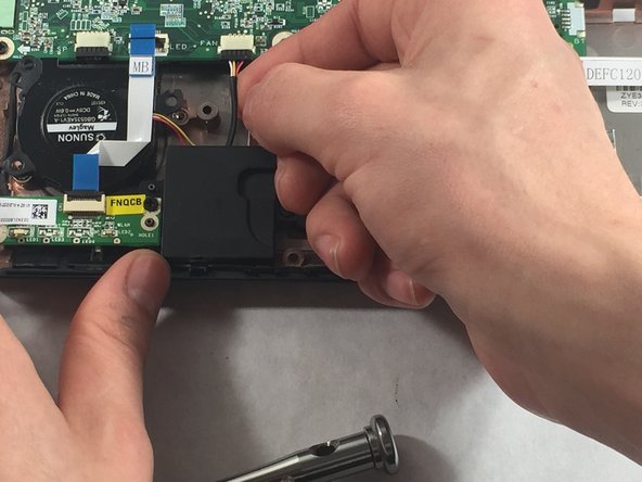

  15. Acer Aspire One 751h-1948 Fan Replacement, Fan: crwdns2935265:015crwdnd2935265:01crwdnd2935265:02crwdne2935265:0 Acer Aspire One 751h-1948 Fan Replacement, Fan: crwdns2935265:015crwdnd2935265:02crwdnd2935265:02crwdne2935265:0
    • Use the screwdriver to remove Phillips #0 (M2-L5 mm) screws
  16. Acer Aspire One 751h-1948 Fan Replacement: crwdns2935265:016crwdnd2935265:01crwdnd2935265:02crwdne2935265:0 Acer Aspire One 751h-1948 Fan Replacement: crwdns2935265:016crwdnd2935265:02crwdnd2935265:02crwdne2935265:0
    • Remove the ribbon cable that sits on top of the fan by lifting the small black clip and pulling the blue tab.
    • Use the same technique to remove the ribbon cable from the motherboard.
  17. Acer Aspire One 751h-1948 Fan Replacement: crwdns2935265:017crwdnd2935265:01crwdnd2935265:02crwdne2935265:0 Acer Aspire One 751h-1948 Fan Replacement: crwdns2935265:017crwdnd2935265:02crwdnd2935265:02crwdne2935265:0
    • Unscrew the Phillips #0 (M2-L2.5 mm) screw from the fan, and remove the fan.
