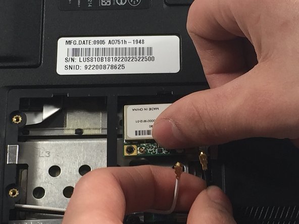

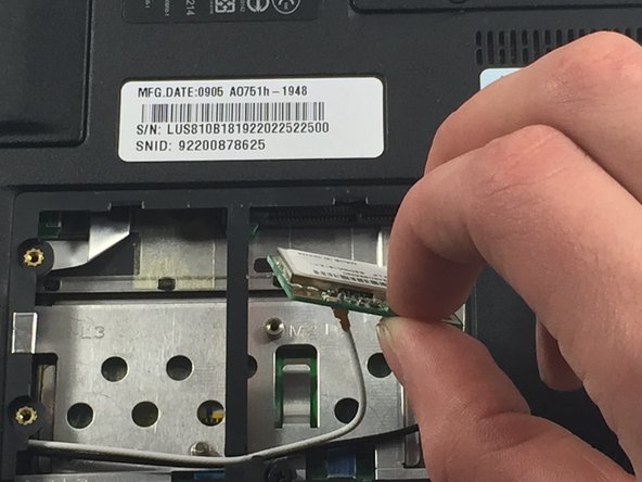

  3. Acer Aspire One 751h-1948 Display Replacement, Network Card: crwdns2935265:03crwdnd2935265:01crwdnd2935265:02crwdne2935265:0 Acer Aspire One 751h-1948 Display Replacement, Network Card: crwdns2935265:03crwdnd2935265:02crwdnd2935265:02crwdne2935265:0
    • Unscrew the two Phillips #0 (M2-L2.5 mm) holding down the network card panel.
    • These screws don't come all the way out.
  4. Acer Aspire One 751h-1948 Display Replacement: crwdns2935265:04crwdnd2935265:01crwdnd2935265:03crwdne2935265:0 Acer Aspire One 751h-1948 Display Replacement: crwdns2935265:04crwdnd2935265:02crwdnd2935265:03crwdne2935265:0 Acer Aspire One 751h-1948 Display Replacement: crwdns2935265:04crwdnd2935265:03crwdnd2935265:03crwdne2935265:0
    • Unplug the two connecting cables by lifting them up. They should unclip easily.
  5. Acer Aspire One 751h-1948 Display Replacement: crwdns2935265:05crwdnd2935265:01crwdnd2935265:03crwdne2935265:0 Acer Aspire One 751h-1948 Display Replacement: crwdns2935265:05crwdnd2935265:02crwdnd2935265:03crwdne2935265:0 Acer Aspire One 751h-1948 Display Replacement: crwdns2935265:05crwdnd2935265:03crwdnd2935265:03crwdne2935265:0
    • Remove the screw Phillips #0 (M2-L3 mm) holding down the network card. Pull out the card.

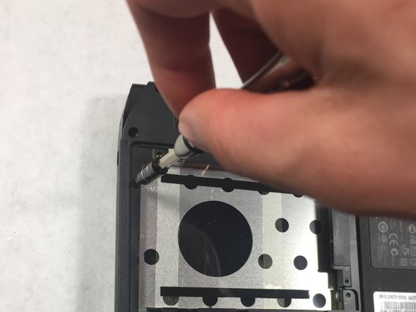

  6. Acer Aspire One 751h-1948 Display Replacement, Hard Drive: crwdns2935265:06crwdnd2935265:01crwdnd2935265:01crwdne2935265:0
    • Unscrew the Phillips 0# (M2 L2.5 mm) screw and remove the cover panel.
    • These screws will not come out all the way.

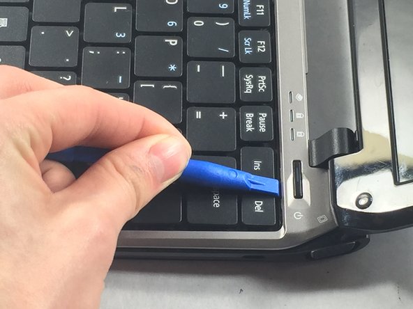

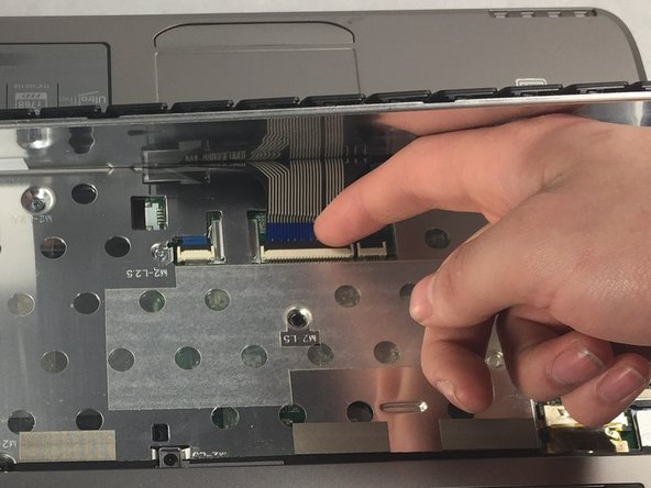

  9. Acer Aspire One 751h-1948 Display Replacement, Keyboard: crwdns2935265:09crwdnd2935265:01crwdnd2935265:03crwdne2935265:0 Acer Aspire One 751h-1948 Display Replacement, Keyboard: crwdns2935265:09crwdnd2935265:02crwdnd2935265:03crwdne2935265:0 Acer Aspire One 751h-1948 Display Replacement, Keyboard: crwdns2935265:09crwdnd2935265:03crwdnd2935265:03crwdne2935265:0
    • Use the plastic opening tool to push in each of the four clips and carefully lift the keyboard.
    • Don't lift the keyboard completely so that you don't damage the ribbon cable underneath.
  10. Acer Aspire One 751h-1948 Display Replacement: crwdns2935265:010crwdnd2935265:01crwdnd2935265:02crwdne2935265:0 Acer Aspire One 751h-1948 Display Replacement: crwdns2935265:010crwdnd2935265:02crwdnd2935265:02crwdne2935265:0
    • When you remove the keyboard, be careful not to damage the ribbon cable that attaches it to the motherboard.
    • Unplug the ribbon cable by gently lifting the black tab up. Then remove the cable.

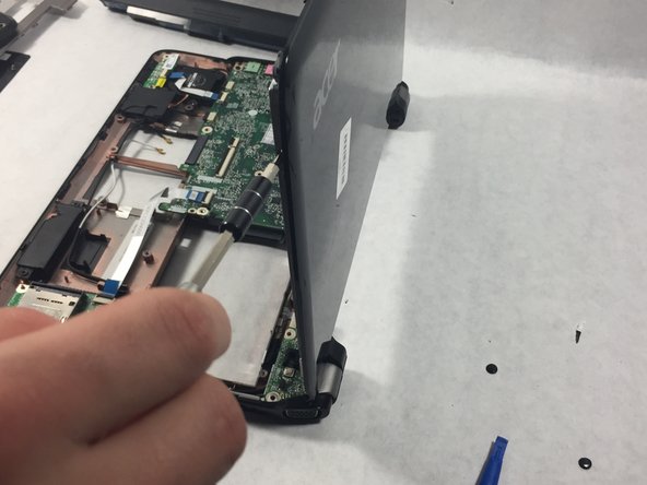

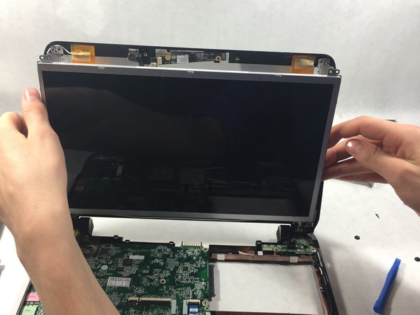

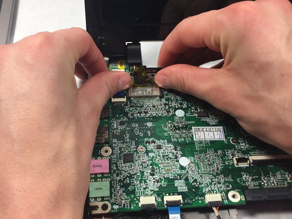

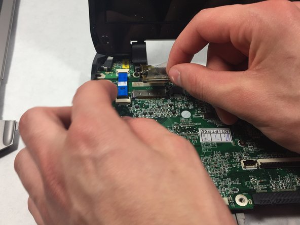

  11. Acer Aspire One 751h-1948 Display Replacement, Display: crwdns2935265:011crwdnd2935265:01crwdnd2935265:03crwdne2935265:0 Acer Aspire One 751h-1948 Display Replacement, Display: crwdns2935265:011crwdnd2935265:02crwdnd2935265:03crwdne2935265:0 Acer Aspire One 751h-1948 Display Replacement, Display: crwdns2935265:011crwdnd2935265:03crwdnd2935265:03crwdne2935265:0
    • Unplug the SCD cable
  12. Acer Aspire One 751h-1948 Display Replacement: crwdns2935265:012crwdnd2935265:01crwdnd2935265:02crwdne2935265:0 Acer Aspire One 751h-1948 Display Replacement: crwdns2935265:012crwdnd2935265:02crwdnd2935265:02crwdne2935265:0

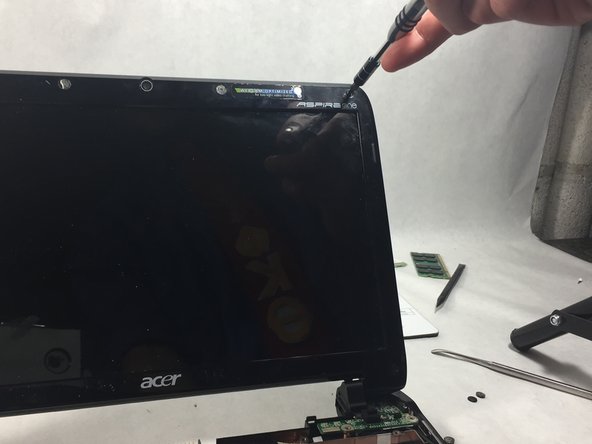

    • Use the spudger to remove all rubber pads covering the screws for the upper casing.
    • Then unscrew all the Phillips #0 (M2-L5 mm) screws under rubber pads.

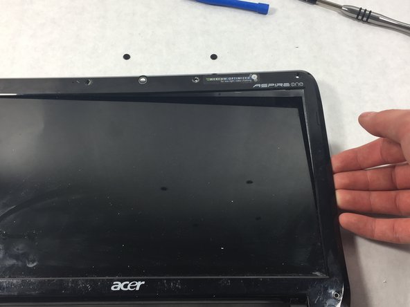

  13. Acer Aspire One 751h-1948 Display Replacement: crwdns2935265:013crwdnd2935265:01crwdnd2935265:03crwdne2935265:0 Acer Aspire One 751h-1948 Display Replacement: crwdns2935265:013crwdnd2935265:02crwdnd2935265:03crwdne2935265:0 Acer Aspire One 751h-1948 Display Replacement: crwdns2935265:013crwdnd2935265:03crwdnd2935265:03crwdne2935265:0
    • Separate the upper casing from the display.
  14. Acer Aspire One 751h-1948 Display Replacement: crwdns2935265:014crwdnd2935265:01crwdnd2935265:03crwdne2935265:0 Acer Aspire One 751h-1948 Display Replacement: crwdns2935265:014crwdnd2935265:02crwdnd2935265:03crwdne2935265:0 Acer Aspire One 751h-1948 Display Replacement: crwdns2935265:014crwdnd2935265:03crwdnd2935265:03crwdne2935265:0

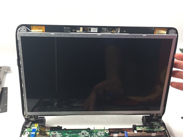

    • Unscrew all the Phillips 0# (M2-L2.5 mm) on each side of the display.
  15. Acer Aspire One 751h-1948 Display Replacement: crwdns2935265:015crwdnd2935265:01crwdnd2935265:01crwdne2935265:0
    • Separate the screen from the metal frame that secures it to the upper casing and remove the screen.
    • Be careful, the display is very sensitive.
