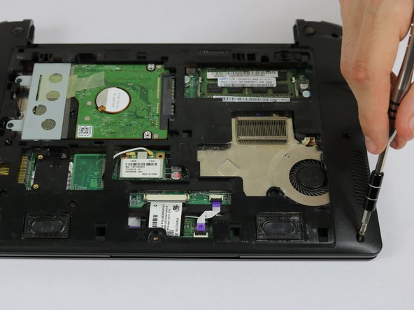

  6. Acer Aspire One 725-0845 Touchpad Replacement, Inner Frame: crwdns2935265:06crwdnd2935265:01crwdnd2935265:03crwdne2935265:0 Acer Aspire One 725-0845 Touchpad Replacement, Inner Frame: crwdns2935265:06crwdnd2935265:02crwdnd2935265:03crwdne2935265:0 Acer Aspire One 725-0845 Touchpad Replacement, Inner Frame: crwdns2935265:06crwdnd2935265:03crwdnd2935265:03crwdne2935265:0
    • Using the JIS J1 Screwdriver Bit and Driver, remove the six outside screws (7.0 mm).
    • Using the JIS J1 Screwdriver Bit and Driver, remove the seven inside screws (8.0 mm).
    • Using the JIS J1 Screwdriver Bit and Driver, remove the one inside screw (3.0 mm).

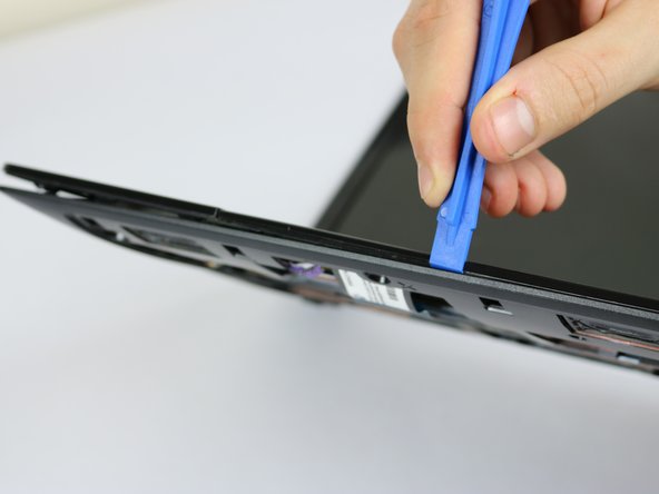

    • Flip the device over and open it.
    • Using the plastic opening tools, remove the cover/palm rest from the frame of the device.
  9. Acer Aspire One 725-0845 Touchpad Replacement, Keyboard: crwdns2935265:09crwdnd2935265:01crwdnd2935265:02crwdne2935265:0 Acer Aspire One 725-0845 Touchpad Replacement, Keyboard: crwdns2935265:09crwdnd2935265:02crwdnd2935265:02crwdne2935265:0

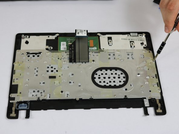

    • Using the JIS J1 Screwdriver Bit and Driver, remove the 17 screws (3.0 mm) from the back of the keyboard.
  10. Acer Aspire One 725-0845 Touchpad Replacement: crwdns2935265:010crwdnd2935265:01crwdnd2935265:02crwdne2935265:0 Acer Aspire One 725-0845 Touchpad Replacement: crwdns2935265:010crwdnd2935265:02crwdnd2935265:02crwdne2935265:0
    • Remove the keyboard by lifting up and away from the cover/palm rest. Be careful with the keyboard connection during this step.
    • To replace an individual key, remove the key from the keyboard using a plastic opening tool.
  11. Acer Aspire One 725-0845 Touchpad Replacement, Touchpad: crwdns2935265:011crwdnd2935265:01crwdnd2935265:02crwdne2935265:0 Acer Aspire One 725-0845 Touchpad Replacement, Touchpad: crwdns2935265:011crwdnd2935265:02crwdnd2935265:02crwdne2935265:0
    • Using the JIS J1 Screwdriver Bit and Driver, remove the two screws (7.0 mm) from touchpad buttons.
  12. Acer Aspire One 725-0845 Touchpad Replacement: crwdns2935265:012crwdnd2935265:01crwdnd2935265:02crwdne2935265:0 Acer Aspire One 725-0845 Touchpad Replacement: crwdns2935265:012crwdnd2935265:02crwdnd2935265:02crwdne2935265:0
    • On the cover/palm rest, lift the black locks for the touchpad buttons into the upward position.
    • Remove the connection for the touchpad buttons by gently pulling the purple tabs away from the locks.
    • Remove touchpad buttons by lifting them up and away from the cover/palm rest.
