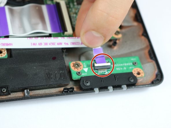

  9. Acer Aspire One 725-0845 Speaker Replacement, Speaker: crwdns2935265:09crwdnd2935265:01crwdnd2935265:02crwdne2935265:0 Acer Aspire One 725-0845 Speaker Replacement, Speaker: crwdns2935265:09crwdnd2935265:02crwdnd2935265:02crwdne2935265:0
    • Lift the black locks for the indicator light connections into the upward position.
    • Remove the indicator light connection by gently pulling the purple tabs away from the locks.
