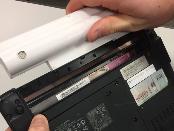

    • Make sure the Acer Aspire One 532h-2806 is powered off and disconnected from any power outlets.
    • Turn the device, upside down.
    • The battery is located on the backside of the laptop. On this version, it is white.
  2. Acer Aspire One 532h-2806 Battery Replacement: crwdns2935265:02crwdnd2935265:01crwdnd2935265:02crwdne2935265:0 Acer Aspire One 532h-2806 Battery Replacement: crwdns2935265:02crwdnd2935265:02crwdnd2935265:02crwdne2935265:0
    • Place your right thumb on the slide-release button under the battery on the right side.
    • Slide the button to the right to unlock the battery. The slide-release will turn red.
    • Place your left thumb on the slide-release button under the battery on the left side.
    • Slide the button to the left. This will release the battery.
  3. Acer Aspire One 532h-2806 Battery Replacement: crwdns2935265:03crwdnd2935265:01crwdnd2935265:02crwdne2935265:0 Acer Aspire One 532h-2806 Battery Replacement: crwdns2935265:03crwdnd2935265:02crwdnd2935265:02crwdne2935265:0
    • Slide the battery away from the computer.
