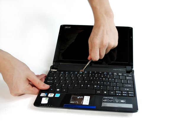

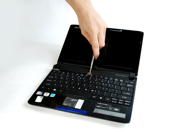

  5. Acer Aspire One 532h-2527 Keyboard Replacement, Keyboard: crwdns2935265:05crwdnd2935265:01crwdnd2935265:01crwdne2935265:0
    • Locate the three latches along the top crevice along the top rows of keys and the plastic boarder.
  6. Acer Aspire One 532h-2527 Keyboard Replacement: crwdns2935265:06crwdnd2935265:01crwdnd2935265:03crwdne2935265:0 Acer Aspire One 532h-2527 Keyboard Replacement: crwdns2935265:06crwdnd2935265:02crwdnd2935265:03crwdne2935265:0 Acer Aspire One 532h-2527 Keyboard Replacement: crwdns2935265:06crwdnd2935265:03crwdnd2935265:03crwdne2935265:0
    • Using the metal spudger, gently pry each tab releasing the keyboard. Make sure as you move to each new one that the previous one does not reset itself.
  7. Acer Aspire One 532h-2527 Keyboard Replacement: crwdns2935265:07crwdnd2935265:01crwdnd2935265:01crwdne2935265:0
    • Check for tabs on the side of the keyboard.
    • If there are no tabs lift the top of the keyboard.
