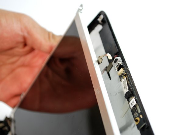

  9. Acer Aspire One 532h-2527  Screen Replacement: crwdns2935265:09crwdnd2935265:01crwdnd2935265:02crwdne2935265:0 Acer Aspire One 532h-2527  Screen Replacement: crwdns2935265:09crwdnd2935265:02crwdnd2935265:02crwdne2935265:0
    • Using the plastic opening tool, gently lift the screen up from the back of the plastic laptop cover.
    • Use the plastic opening tool to remove the no fuss ribbon connector from the webcam component.
  10. Acer Aspire One 532h-2527  Screen Replacement: crwdns2935265:010crwdnd2935265:01crwdnd2935265:02crwdne2935265:0 Acer Aspire One 532h-2527  Screen Replacement: crwdns2935265:010crwdnd2935265:02crwdnd2935265:02crwdne2935265:0
    • Locate the no fuss ribbon connector wire.
    • Peel it from the backside of the screen.
  11. Acer Aspire One 532h-2527  Screen Replacement: crwdns2935265:011crwdnd2935265:01crwdnd2935265:02crwdne2935265:0 Acer Aspire One 532h-2527  Screen Replacement: crwdns2935265:011crwdnd2935265:02crwdnd2935265:02crwdne2935265:0
    • Locate the yellow tape on the back of the screen and peel it off partially.
    • Locate the ZIF (zero insertion force) connector cable.
    • Carefully unplug the ZIF connector.
    • No excess force is needed to remove the ZIF connector as its name implies.
    • Be sure to only pull the connector from its head and not the ribbon wire as it is very delicate.
