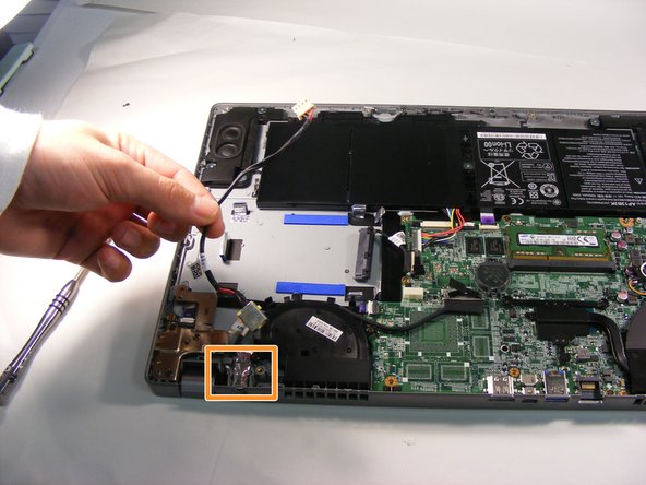

    • Use a Phillips #1 screwdriver to remove all eighteen 2.12 mm screws from the back plate of your Acer Aspire.
  2. Acer Aspire M5-583P-9688 Power Jack Replacement: crwdns2935265:02crwdnd2935265:01crwdnd2935265:02crwdne2935265:0 Acer Aspire M5-583P-9688 Power Jack Replacement: crwdns2935265:02crwdnd2935265:02crwdnd2935265:02crwdne2935265:0
    • Use the spudger to remove the back plate in the highlighted area to carefully pop out the back plate.
  3. Acer Aspire M5-583P-9688 Power Jack Replacement: crwdns2935265:03crwdnd2935265:01crwdnd2935265:02crwdne2935265:0 Acer Aspire M5-583P-9688 Power Jack Replacement: crwdns2935265:03crwdnd2935265:02crwdnd2935265:02crwdne2935265:0
    • Unplug the power jack from the receptor port on the motherboard, highlighted in red.
    • Remove the power jack from designated area on the side of the computer, highlighted in orange.
