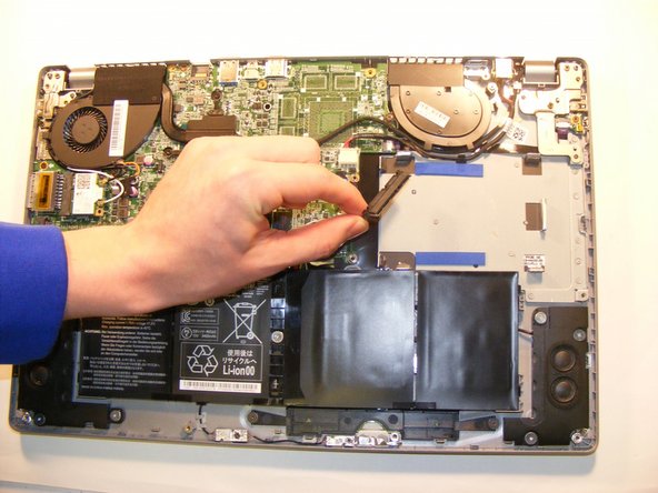

    • Remove the 18 marked screws (2.12 mm) using a Phillips #1 head screwdriver.
  2. Acer Aspire M5-583P-9688 Hard Drive Replacement: crwdns2935265:02crwdnd2935265:01crwdnd2935265:02crwdne2935265:0 Acer Aspire M5-583P-9688 Hard Drive Replacement: crwdns2935265:02crwdnd2935265:02crwdnd2935265:02crwdne2935265:0
    • Use the spudger to slowly work your way around the perimeter starting at the marked location to pop the bottom cover off.
  3. Acer Aspire M5-583P-9688 Hard Drive Replacement: crwdns2935265:03crwdnd2935265:01crwdnd2935265:02crwdne2935265:0 Acer Aspire M5-583P-9688 Hard Drive Replacement: crwdns2935265:03crwdnd2935265:02crwdnd2935265:02crwdne2935265:0
    • This particular laptop does not have a hard drive. The red rectangle is where your hard drive will be.
    • To remove the hard drive, carefully take it out of the brackets holding it in place. Once you have it out of the brackets, remove the connector from the hard drive.
