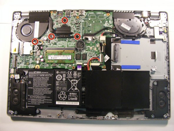

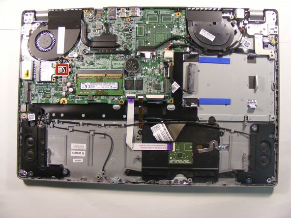

    • Remove the four marked screws (2.31mm) using a Phillips #1 Screwdriver.
  4. Acer Aspire M5-583P-9688 Fan Replacement: crwdns2935265:04crwdnd2935265:01crwdnd2935265:02crwdne2935265:0 Acer Aspire M5-583P-9688 Fan Replacement: crwdns2935265:04crwdnd2935265:02crwdnd2935265:02crwdne2935265:0
    • After the screws are removed, you will need to unplug it from the motherboard shown by the red rectangle. After it is unplugged, then you will be able to remove the fan completely.
