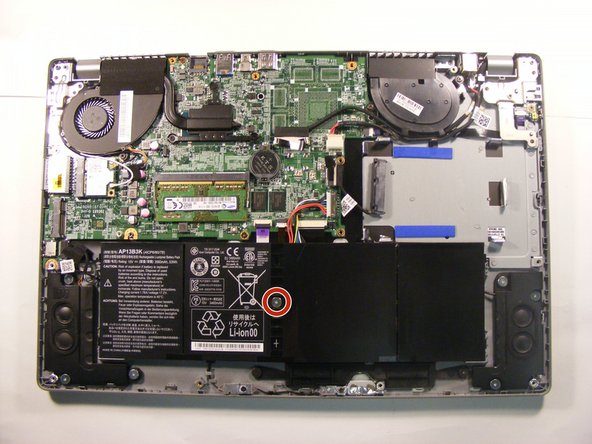

    • Remove all 18 marked screws (2.12 mm) using a Phillips #1 Screwdriver.
  2. Acer Aspire M5-583P-9688 Battery Replacement: crwdns2935265:02crwdnd2935265:01crwdnd2935265:02crwdne2935265:0 Acer Aspire M5-583P-9688 Battery Replacement: crwdns2935265:02crwdnd2935265:02crwdnd2935265:02crwdne2935265:0
    • Use the spudger to slowly work your way around the perimeter starting at the marked location to pop the bottom cover off.
  3. Acer Aspire M5-583P-9688 Battery Replacement: crwdns2935265:03crwdnd2935265:01crwdnd2935265:02crwdne2935265:0 Acer Aspire M5-583P-9688 Battery Replacement: crwdns2935265:03crwdnd2935265:02crwdnd2935265:02crwdne2935265:0
    • Remove the 1 marked screw (3.3 mm) holding the battery in place using a Phillips #1 Screwdriver.
  4. Acer Aspire M5-583P-9688 Battery Replacement: crwdns2935265:04crwdnd2935265:01crwdnd2935265:02crwdne2935265:0 Acer Aspire M5-583P-9688 Battery Replacement: crwdns2935265:04crwdnd2935265:02crwdnd2935265:02crwdne2935265:0

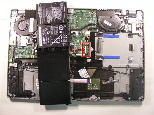

    • Unplug the marked plug from the motherboard and this will complete the removal of the battery.
