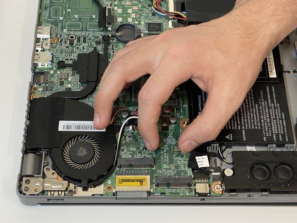

  6. Acer Aspire M5-583P-6423 mSATA Solid State Drive (mSATA SSD) Replacement, mSATA Solid State Drive (mSATA SSD): crwdns2935265:06crwdnd2935265:01crwdnd2935265:03crwdne2935265:0 Acer Aspire M5-583P-6423 mSATA Solid State Drive (mSATA SSD) Replacement, mSATA Solid State Drive (mSATA SSD): crwdns2935265:06crwdnd2935265:02crwdnd2935265:03crwdne2935265:0 Acer Aspire M5-583P-6423 mSATA Solid State Drive (mSATA SSD) Replacement, mSATA Solid State Drive (mSATA SSD): crwdns2935265:06crwdnd2935265:03crwdnd2935265:03crwdne2935265:0
    • The boxed area shows where your mSATA Solid State Drive (mSATA SSD) connects to your laptop's motherboard.
    • Remove the M2x3mm screw using the Phillips #00 Screwdriver.
    • If your laptop already has an mSATA SSD connected, remove it by lifting it up to a 45° angle and pulling it out.
