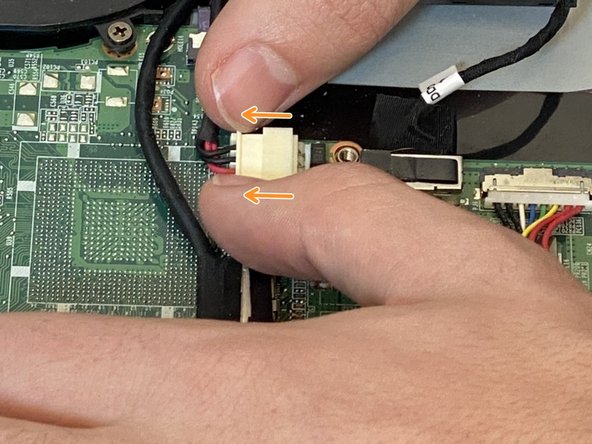

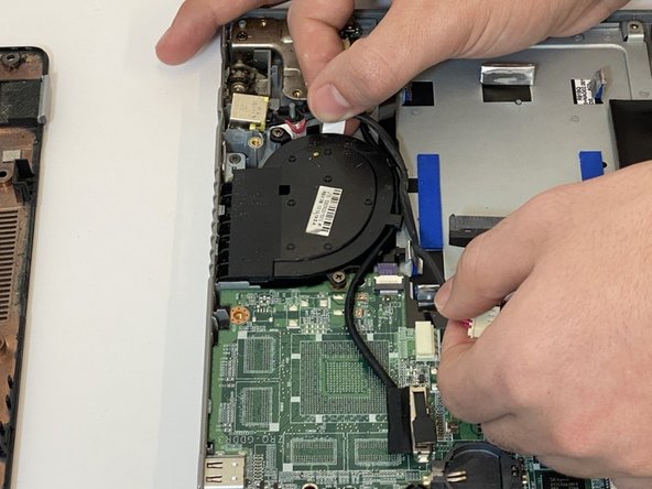

  6. Acer Aspire M5-583P-6423 Battery Jack Replacement, Battery Jack: crwdns2935265:06crwdnd2935265:01crwdnd2935265:03crwdne2935265:0 Acer Aspire M5-583P-6423 Battery Jack Replacement, Battery Jack: crwdns2935265:06crwdnd2935265:02crwdnd2935265:03crwdne2935265:0 Acer Aspire M5-583P-6423 Battery Jack Replacement, Battery Jack: crwdns2935265:06crwdnd2935265:03crwdnd2935265:03crwdne2935265:0
    • Your laptop's battery jack is located in the red boxed area. The red arrow shows where your power cable connects.
    • Disconnect the battery jack by gently pushing away the white slot in the arrows direction.
    • Gently grab the battery jack cable and remove it from the laptop’s motherboard.
