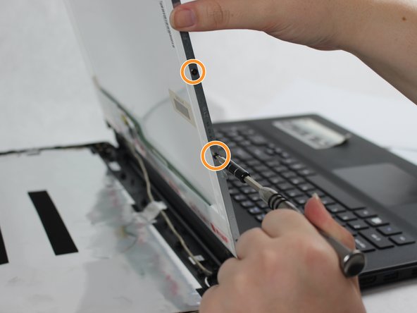

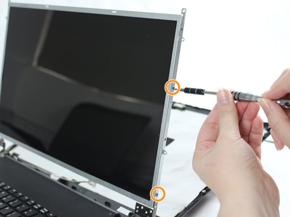

  6. Acer Aspire ES1-711-P1UV Screen Replacement: crwdns2935265:06crwdnd2935265:01crwdnd2935265:03crwdne2935265:0 Acer Aspire ES1-711-P1UV Screen Replacement: crwdns2935265:06crwdnd2935265:02crwdnd2935265:03crwdne2935265:0 Acer Aspire ES1-711-P1UV Screen Replacement: crwdns2935265:06crwdnd2935265:03crwdnd2935265:03crwdne2935265:0
    • Use the Phillips #0 screwdriver to remove the fourteen 5mm screws around the screen.
    • Use the Phillips #0 screwdriver to remove the four 4mm screws holding in the screen.
    • Before unscrewing the screen, place a paper on the keyboard to protect the screen from scratches.

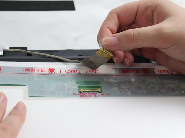

  7. Acer Aspire ES1-711-P1UV Screen Replacement: crwdns2935265:07crwdnd2935265:01crwdnd2935265:02crwdne2935265:0 Acer Aspire ES1-711-P1UV Screen Replacement: crwdns2935265:07crwdnd2935265:02crwdnd2935265:02crwdne2935265:0
    • With the screen on the paper, detach the Zero Insertion Force (ZIF) connector attaching the screen to the video cable inside of the front cover.
    • To remove the ZIF use your finger to flip up the top cover and gently pull the cable out.
    • Be sure to pry open the hinged flap not the connector socket
    • Gently remove the screen from laptop.
