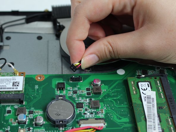

  5. Acer Aspire ES1-711-P1UV Fan Replacement, Fan: crwdns2935265:05crwdnd2935265:01crwdnd2935265:01crwdne2935265:0
    • Locate and remove the 5 mm screw using the Phillips #0 screwdriver.
    • Unscrew the four 5mm screws still holding down the fan.
    • The four 5mm screws in the second part of this step cannot be fully removed from the fan. Loosen them and continue on to Step 6.
  6. Acer Aspire ES1-711-P1UV Fan Replacement: crwdns2935265:06crwdnd2935265:01crwdnd2935265:03crwdne2935265:0 Acer Aspire ES1-711-P1UV Fan Replacement: crwdns2935265:06crwdnd2935265:02crwdnd2935265:03crwdne2935265:0 Acer Aspire ES1-711-P1UV Fan Replacement: crwdns2935265:06crwdnd2935265:03crwdnd2935265:03crwdne2935265:0
    • Disconnect the red, white, black, and yellow bundled cable connectors from the motherboard by gently pulling them.
    • Remove the fan assembly.
