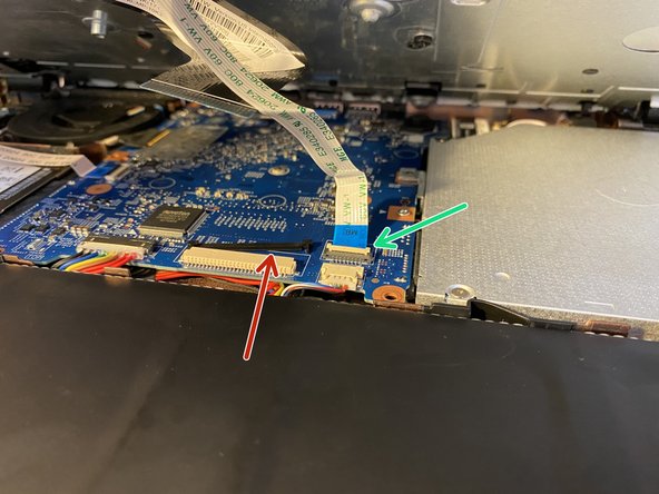

    • There are 2 ribbon cables are connecting the keyboard and Touch pad to the Motherboard.
  3. Acer Aspire ES1-512-C96S Battery Replacement, Disconnecting Keyboard and Touchpad Cables: crwdns2935265:03crwdnd2935265:01crwdnd2935265:03crwdne2935265:0 Acer Aspire ES1-512-C96S Battery Replacement, Disconnecting Keyboard and Touchpad Cables: crwdns2935265:03crwdnd2935265:02crwdnd2935265:03crwdne2935265:0 Acer Aspire ES1-512-C96S Battery Replacement, Disconnecting Keyboard and Touchpad Cables: crwdns2935265:03crwdnd2935265:03crwdnd2935265:03crwdne2935265:0
    • Locate the lock for the larger Ribbon cable on the sides of the cable. Slide them back, Gently, until they release the cable. The lock may fall off, that's okay. It will reattach.
    • Notice the lock bar is off of the connector.
    • The smaller ribbon cable has a latch, that is pulled upward, gently, until it disengages.
    • Now the Keyboard should remove completely.

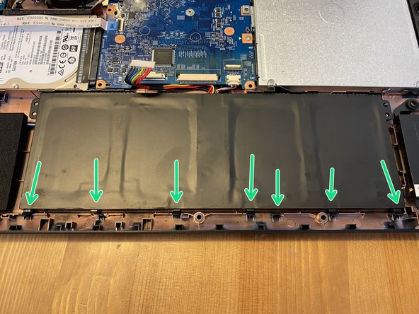

  4. Acer Aspire ES1-512-C96S Battery Replacement, Removing Battery from locks: crwdns2935265:04crwdnd2935265:01crwdnd2935265:03crwdne2935265:0 Acer Aspire ES1-512-C96S Battery Replacement, Removing Battery from locks: crwdns2935265:04crwdnd2935265:02crwdnd2935265:03crwdne2935265:0 Acer Aspire ES1-512-C96S Battery Replacement, Removing Battery from locks: crwdns2935265:04crwdnd2935265:03crwdnd2935265:03crwdne2935265:0
    • Disconnect the Battery from the Motherboard and there is 1 screw, PH0, that is holding the battery in place.
    • There are also several tabs that are holding the battery in place. Bend the tabs down slightly, just enough to disengage them.
    • Once all locking tabs have been moved, lift from bottom and pull out.
