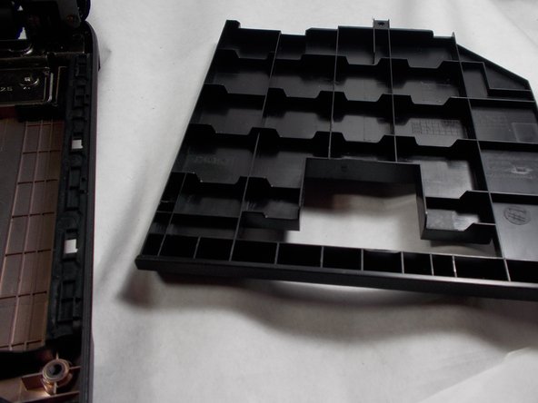

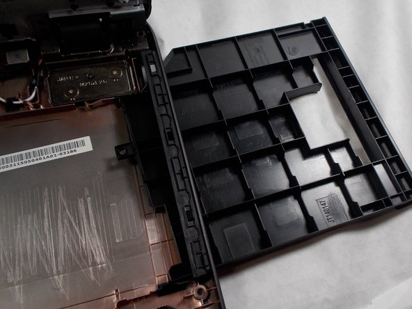

  7. Acer Aspire ES1-512-C80E Disk Drive Replacement, Disk Drive: crwdns2935265:07crwdnd2935265:01crwdnd2935265:03crwdne2935265:0 Acer Aspire ES1-512-C80E Disk Drive Replacement, Disk Drive: crwdns2935265:07crwdnd2935265:02crwdnd2935265:03crwdne2935265:0 Acer Aspire ES1-512-C80E Disk Drive Replacement, Disk Drive: crwdns2935265:07crwdnd2935265:03crwdnd2935265:03crwdne2935265:0
    • Push the disk drive out of the side slot.
To reassemble your device, follow the steps in reverse order.
