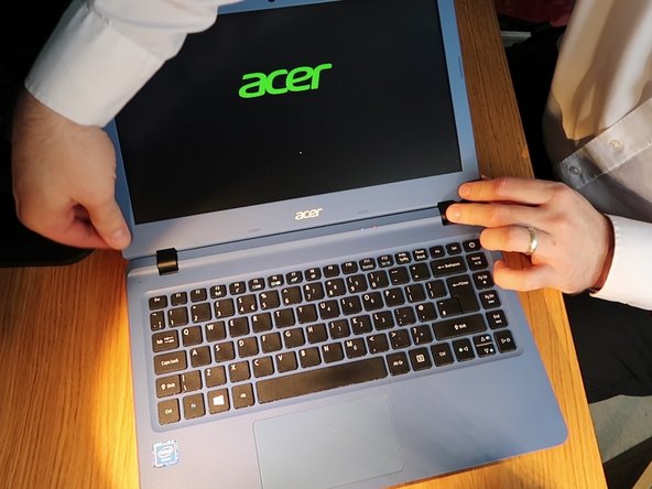

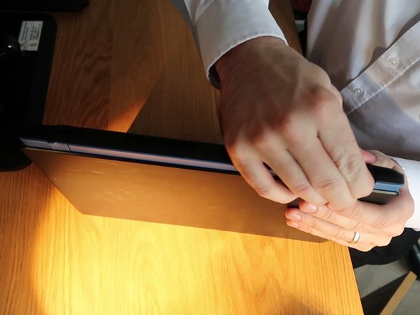

    • Grab a spudger and work your way around the outer edge of the screen
    • Lean the screen all the way back to remove the plastic frame from the hinges at the bottom

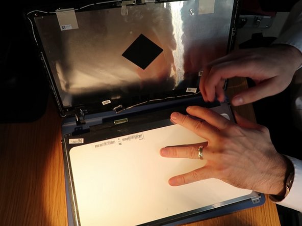

    • Unscrew the 4 screws around the edge of the screen
    • Lean the screen all the way forward on to the keyboard
  3. Acer Aspire ES1-332 LCD Screen Replacement: crwdns2935265:03crwdnd2935265:01crwdnd2935265:02crwdne2935265:0 Acer Aspire ES1-332 LCD Screen Replacement: crwdns2935265:03crwdnd2935265:02crwdnd2935265:02crwdne2935265:0
    • Peal up the sticky tape next to the screen connector
    • Pull the connector down carefully away from the screen and disconnect it
  4. Acer Aspire ES1-332 LCD Screen Replacement: crwdns2935265:04crwdnd2935265:01crwdnd2935265:03crwdne2935265:0 Acer Aspire ES1-332 LCD Screen Replacement: crwdns2935265:04crwdnd2935265:02crwdnd2935265:03crwdne2935265:0 Acer Aspire ES1-332 LCD Screen Replacement: crwdns2935265:04crwdnd2935265:03crwdnd2935265:03crwdne2935265:0
    • connect the new screen and screw back in place
    • Turn on the screen to test before putting the screen frame back on
    • Tilt the screen all the way back and push the frame back on hinges 1st.
    • Finally lean the laptop on its edge and clip the back on the hinges back in place.
