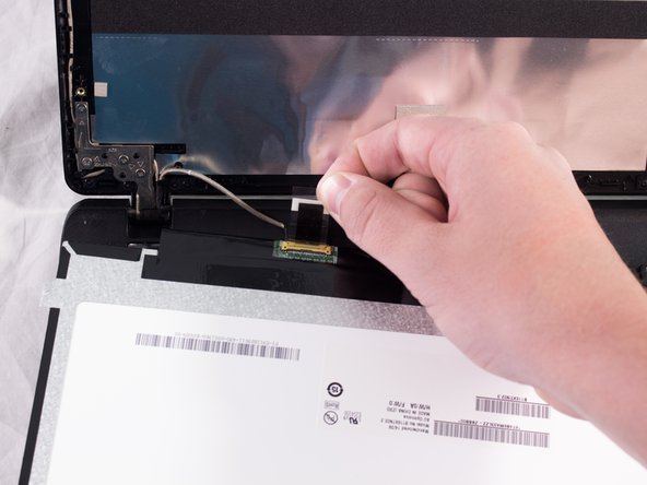

  4. Acer Aspire ES1-111M-C7DE Screen Replacement: crwdns2935265:04crwdnd2935265:01crwdnd2935265:02crwdne2935265:0 Acer Aspire ES1-111M-C7DE Screen Replacement: crwdns2935265:04crwdnd2935265:02crwdnd2935265:02crwdne2935265:0
    • Carefully pull back the tape on the connector until the connector is fully revealed
  5. Acer Aspire ES1-111M-C7DE Screen Replacement: crwdns2935265:05crwdnd2935265:01crwdnd2935265:01crwdne2935265:0
    • Carefully remove the connector from the old screen and connect it to your new, compatible screen
