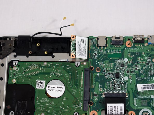

  7. Acer Aspire ES1-111M-C7DE RAM Replacement, Network Card: crwdns2935265:07crwdnd2935265:01crwdnd2935265:02crwdne2935265:0 Acer Aspire ES1-111M-C7DE RAM Replacement, Network Card: crwdns2935265:07crwdnd2935265:02crwdnd2935265:02crwdne2935265:0
    • You will see a white rectangular piece next to the upper left-hand corner of the motherboard that is connected with a black cord and a white cord; this is the network card.
    • Unscrew the one 6.2mm screw in the upper left-hand corner of the network card.

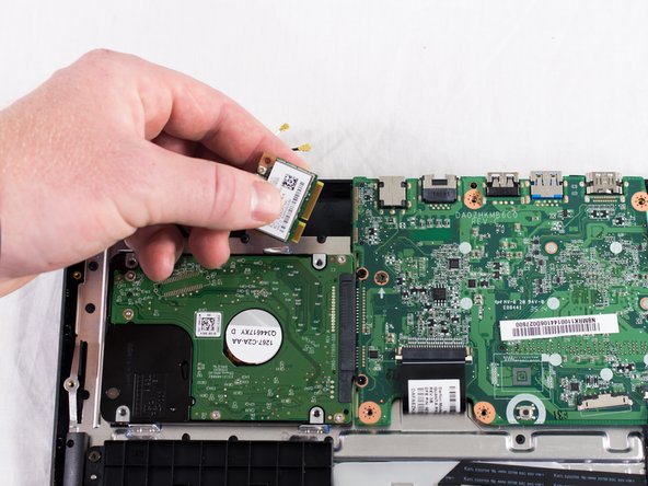

  8. Acer Aspire ES1-111M-C7DE RAM Replacement: crwdns2935265:08crwdnd2935265:01crwdnd2935265:03crwdne2935265:0 Acer Aspire ES1-111M-C7DE RAM Replacement: crwdns2935265:08crwdnd2935265:02crwdnd2935265:03crwdne2935265:0 Acer Aspire ES1-111M-C7DE RAM Replacement: crwdns2935265:08crwdnd2935265:03crwdnd2935265:03crwdne2935265:0
    • Remove the black and the white cords from the network card.
    • Slide the card out of the motherboard and replace it with the new one.

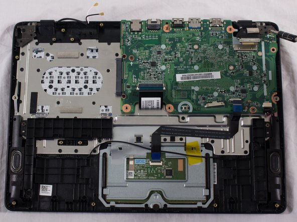

    • Disconnect the remaining connectors from the motherboard.
  10. Acer Aspire ES1-111M-C7DE RAM Replacement: crwdns2935265:010crwdnd2935265:01crwdnd2935265:02crwdne2935265:0 Acer Aspire ES1-111M-C7DE RAM Replacement: crwdns2935265:010crwdnd2935265:02crwdnd2935265:02crwdne2935265:0
    • Unscrew the three 6.2mm screws as indicated by the picture.

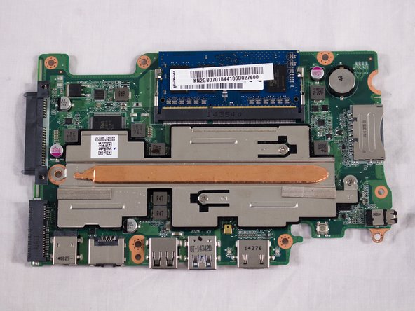

    • Flip the motherboard over.
  12. Acer Aspire ES1-111M-C7DE RAM Replacement: crwdns2935265:012crwdnd2935265:01crwdnd2935265:01crwdne2935265:0
    • Locate the RAM

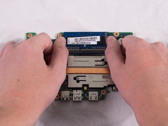

  13. Acer Aspire ES1-111M-C7DE RAM Replacement: crwdns2935265:013crwdnd2935265:01crwdnd2935265:03crwdne2935265:0 Acer Aspire ES1-111M-C7DE RAM Replacement: crwdns2935265:013crwdnd2935265:02crwdnd2935265:03crwdne2935265:0 Acer Aspire ES1-111M-C7DE RAM Replacement: crwdns2935265:013crwdnd2935265:03crwdnd2935265:03crwdne2935265:0
    • Gently push the two metal clips that hold the RAM to the side, as indicated by the picture.
    • It should pop up once done.
  14. Acer Aspire ES1-111M-C7DE RAM Replacement: crwdns2935265:014crwdnd2935265:01crwdnd2935265:01crwdne2935265:0
    • Pull the RAM out.
