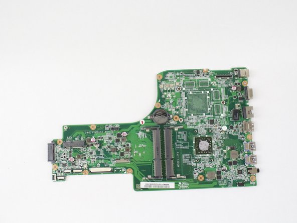

    • Remove the two 6mm J0 screws located in the right and left side of the battery.
    • Make sure to unplug of disconnect the power cable before removing the battery.
  2. Acer Aspire E5-721-64T8 Motherboard Replacement: crwdns2935265:02crwdnd2935265:01crwdnd2935265:02crwdne2935265:0 Acer Aspire E5-721-64T8 Motherboard Replacement: crwdns2935265:02crwdnd2935265:02crwdnd2935265:02crwdne2935265:0
    • Remove the connector from the motherboard.
  3. Acer Aspire E5-721-64T8 Motherboard Replacement: crwdns2935265:03crwdnd2935265:01crwdnd2935265:03crwdne2935265:0 Acer Aspire E5-721-64T8 Motherboard Replacement: crwdns2935265:03crwdnd2935265:02crwdnd2935265:03crwdne2935265:0 Acer Aspire E5-721-64T8 Motherboard Replacement: crwdns2935265:03crwdnd2935265:03crwdnd2935265:03crwdne2935265:0
    • Remove the two 6mm Phillips J0 screws located in the right and left side of heatsink mounts.
    • Remove the four 6mm Phillips J0 screws located on the heatsink power mount.
    • Lift and remove heatsink from motherboard completely.
  4. Acer Aspire E5-721-64T8 Motherboard Replacement: crwdns2935265:04crwdnd2935265:01crwdnd2935265:02crwdne2935265:0 Acer Aspire E5-721-64T8 Motherboard Replacement: crwdns2935265:04crwdnd2935265:02crwdnd2935265:02crwdne2935265:0
    • Remove wi-fi card by pulling from socket.
  5. Acer Aspire E5-721-64T8 Motherboard Replacement: crwdns2935265:05crwdnd2935265:01crwdnd2935265:01crwdne2935265:0
    • Remove screen connector by pulling it upwards.
  6. Acer Aspire E5-721-64T8 Motherboard Replacement: crwdns2935265:06crwdnd2935265:01crwdnd2935265:01crwdne2935265:0
    • Remove speaker connector from the motherboard by pulling on the tab.
  7. Acer Aspire E5-721-64T8 Motherboard Replacement: crwdns2935265:07crwdnd2935265:01crwdnd2935265:03crwdne2935265:0 Acer Aspire E5-721-64T8 Motherboard Replacement: crwdns2935265:07crwdnd2935265:02crwdnd2935265:03crwdne2935265:0 Acer Aspire E5-721-64T8 Motherboard Replacement: crwdns2935265:07crwdnd2935265:03crwdnd2935265:03crwdne2935265:0
    • Remove the four blue tabbed ribbon connectors to the motherboard by lifting white clamps and pulling out connector.
  8. Acer Aspire E5-721-64T8 Motherboard Replacement: crwdns2935265:08crwdnd2935265:01crwdnd2935265:02crwdne2935265:0 Acer Aspire E5-721-64T8 Motherboard Replacement: crwdns2935265:08crwdnd2935265:02crwdnd2935265:02crwdne2935265:0
    • Remove black ribbon connector by lifting white clamp and pulling connector out.
  9. Acer Aspire E5-721-64T8 Motherboard Replacement: crwdns2935265:09crwdnd2935265:01crwdnd2935265:02crwdne2935265:0 Acer Aspire E5-721-64T8 Motherboard Replacement: crwdns2935265:09crwdnd2935265:02crwdnd2935265:02crwdne2935265:0
    • Finally lift motherboard from narrow side and jiggle it out so all ports going through the laptop case on the left slide out.
