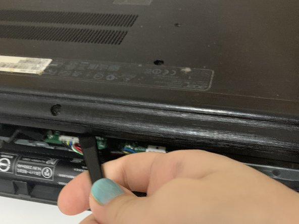

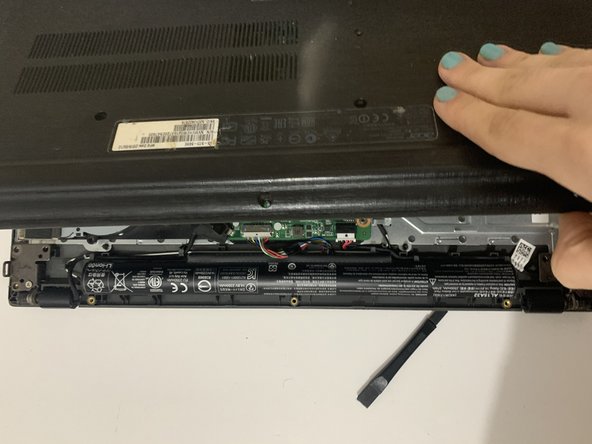

  4. Acer Aspire E5-573G Fan  Replacement: crwdns2935265:04crwdnd2935265:01crwdnd2935265:03crwdne2935265:0 Acer Aspire E5-573G Fan  Replacement: crwdns2935265:04crwdnd2935265:02crwdnd2935265:03crwdne2935265:0 Acer Aspire E5-573G Fan  Replacement: crwdns2935265:04crwdnd2935265:03crwdnd2935265:03crwdne2935265:0
    • Use the spudger to pry open the back cover by sliding it along the sides.
    • Slowly lift the cover upwards.
    • Be gentle while removing the case as it is very thin and might break easily.
