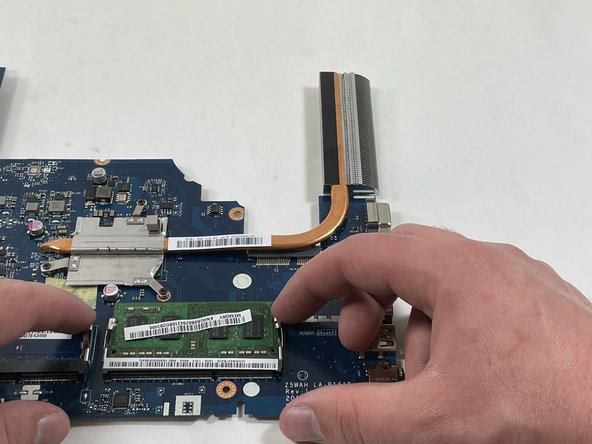

  17. Acer Aspire E5-571P-55TL RAM Replacement, RAM: crwdns2935265:017crwdnd2935265:01crwdnd2935265:02crwdne2935265:0 Acer Aspire E5-571P-55TL RAM Replacement, RAM: crwdns2935265:017crwdnd2935265:02crwdnd2935265:02crwdne2935265:0
    • Flipe the motherboard over.
    • The RAM is locked into place by two clips.
    • Using the tips of each index finger, gently pull the clips away from the RAM module.
  18. Acer Aspire E5-571P-55TL RAM Replacement: crwdns2935265:018crwdnd2935265:01crwdnd2935265:01crwdne2935265:0
    • When the RAM stick is released, slide it out of the slot.
