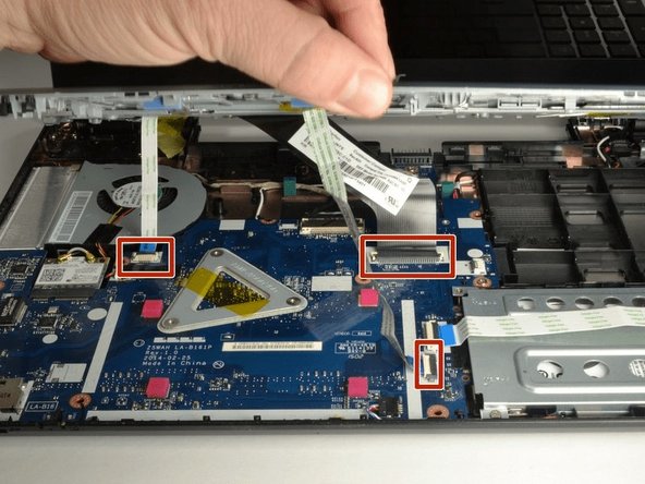

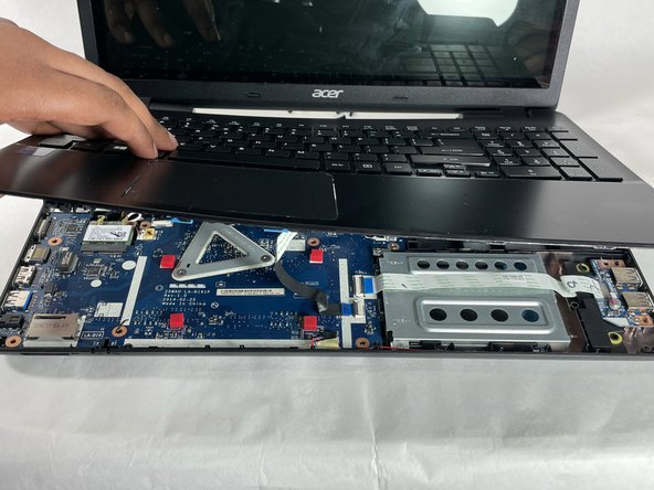

    • Carefully place your fingers underneath the top of the keyboard just below the screen.
    • Pull upwards until you can hear the keyboard click out of place.
    • Continue around the entire laptop, carefully pulling the keyboard and palm rest assembly slightly from the frame to reveal the ribbon connectors.
    • Don't pull the keyboard off the frame yet because it's attached by ribbon connectors.
    • After the keyboard is detached, unplug each of the three ribbon cables and remove the keyboard and palm rest assembly.

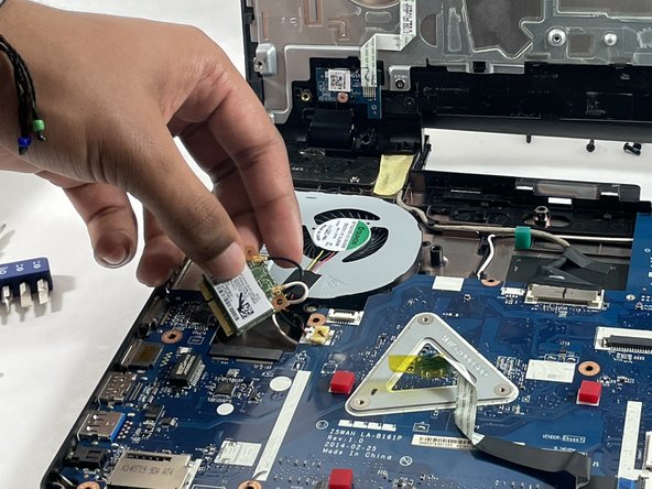

  6. Acer Aspire E5-571P-55TL Motherboard Replacement, CPU Fan: crwdns2935265:06crwdnd2935265:01crwdnd2935265:02crwdne2935265:0 Acer Aspire E5-571P-55TL Motherboard Replacement, CPU Fan: crwdns2935265:06crwdnd2935265:02crwdnd2935265:02crwdne2935265:0
    • Before replacing the CPU fan, you'll have to remove the network card found below the fan.
    • Using a Philips #0 screwdriver, remove the two 3 mm screws from the corners of the Wi-Fi card.
    • Carefully lift the network card from it's slot, and disconnect the two coaxial cables.

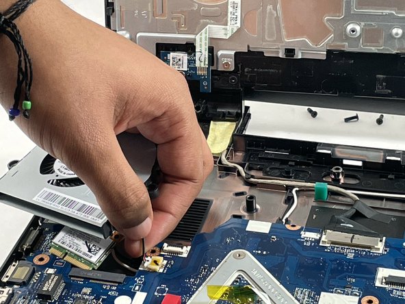

  8. Acer Aspire E5-571P-55TL Motherboard Replacement: crwdns2935265:08crwdnd2935265:01crwdnd2935265:02crwdne2935265:0 Acer Aspire E5-571P-55TL Motherboard Replacement: crwdns2935265:08crwdnd2935265:02crwdnd2935265:02crwdne2935265:0

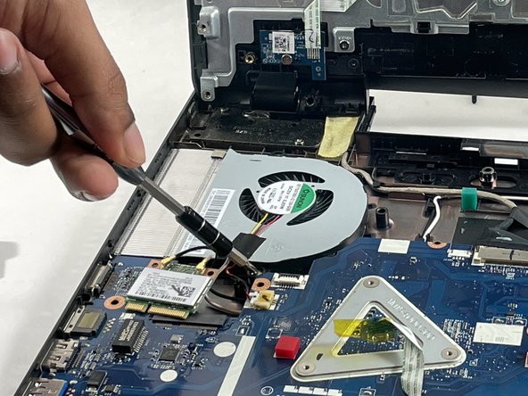

    • Use tweezers to safely remove the fan plug from the motherboard. To remove the plug, gently push left.
  9. Acer Aspire E5-571P-55TL Motherboard Replacement: crwdns2935265:09crwdnd2935265:01crwdnd2935265:01crwdne2935265:0
    • Make sure that all fan wires are disconnected from the board.
    • Lift the curved end of the fan, and safely remove it.

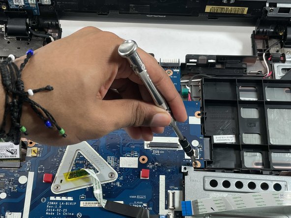

    • With a Phillips #0 screwdriver, remove the two 4 mm screws from the motherboard.

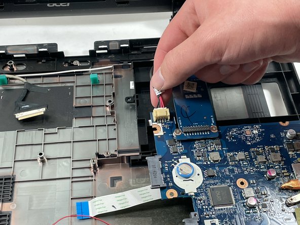

  14. Acer Aspire E5-571P-55TL Motherboard Replacement: crwdns2935265:014crwdnd2935265:01crwdnd2935265:03crwdne2935265:0 Acer Aspire E5-571P-55TL Motherboard Replacement: crwdns2935265:014crwdnd2935265:02crwdnd2935265:03crwdne2935265:0 Acer Aspire E5-571P-55TL Motherboard Replacement: crwdns2935265:014crwdnd2935265:03crwdnd2935265:03crwdne2935265:0

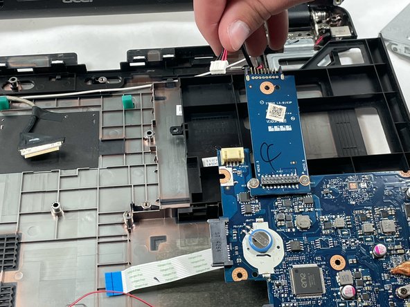

    • Carefully disconnect the speaker connection to the motherboard.

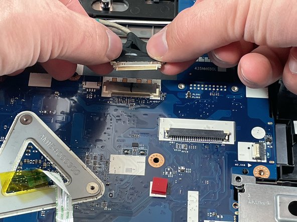

  15. Acer Aspire E5-571P-55TL Motherboard Replacement: crwdns2935265:015crwdnd2935265:01crwdnd2935265:03crwdne2935265:0 Acer Aspire E5-571P-55TL Motherboard Replacement: crwdns2935265:015crwdnd2935265:02crwdnd2935265:03crwdne2935265:0 Acer Aspire E5-571P-55TL Motherboard Replacement: crwdns2935265:015crwdnd2935265:03crwdnd2935265:03crwdne2935265:0

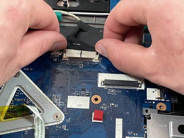

    • The last connection to the motherboard is the screen. Gently disconnect the cable from the motherboard.
  16. Acer Aspire E5-571P-55TL Motherboard Replacement: crwdns2935265:016crwdnd2935265:01crwdnd2935265:01crwdne2935265:0
    • Lift the motherboard up from the top right corner, and then pull it right to release it from the case.
