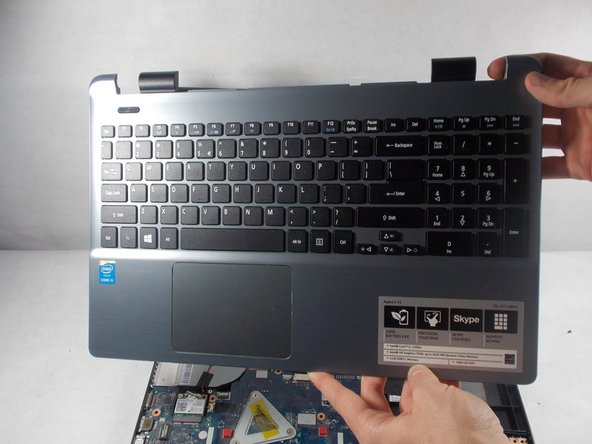

  3. Acer Aspire E5-571-58CG Power Jack Replacement, Power Jack: crwdns2935265:03crwdnd2935265:01crwdnd2935265:03crwdne2935265:0 Acer Aspire E5-571-58CG Power Jack Replacement, Power Jack: crwdns2935265:03crwdnd2935265:02crwdnd2935265:03crwdne2935265:0 Acer Aspire E5-571-58CG Power Jack Replacement, Power Jack: crwdns2935265:03crwdnd2935265:03crwdnd2935265:03crwdne2935265:0
    • Remove the top panel of the laptop with the plastic opening tool.

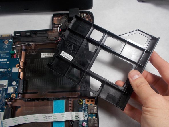

  4. Acer Aspire E5-571-58CG Power Jack Replacement: crwdns2935265:04crwdnd2935265:01crwdnd2935265:02crwdne2935265:0 Acer Aspire E5-571-58CG Power Jack Replacement: crwdns2935265:04crwdnd2935265:02crwdnd2935265:02crwdne2935265:0
    • Remove the plastic safeguard from the CD drive slot.
  5. Acer Aspire E5-571-58CG Power Jack Replacement: crwdns2935265:05crwdnd2935265:01crwdnd2935265:03crwdne2935265:0 Acer Aspire E5-571-58CG Power Jack Replacement: crwdns2935265:05crwdnd2935265:02crwdnd2935265:03crwdne2935265:0 Acer Aspire E5-571-58CG Power Jack Replacement: crwdns2935265:05crwdnd2935265:03crwdnd2935265:03crwdne2935265:0
    • Remove the marked screws with the JIS #00 screwdriver.

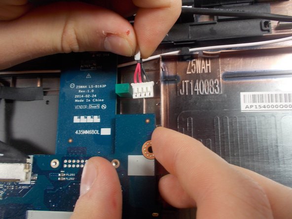

  6. Acer Aspire E5-571-58CG Power Jack Replacement: crwdns2935265:06crwdnd2935265:01crwdnd2935265:02crwdne2935265:0 Acer Aspire E5-571-58CG Power Jack Replacement: crwdns2935265:06crwdnd2935265:02crwdnd2935265:02crwdne2935265:0
    • Disconnect the opposite end of the power jack from the motherboard by carefully pulling the wire.

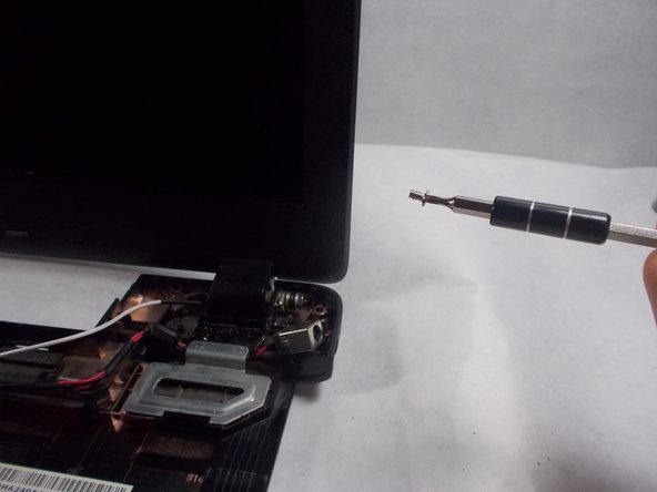

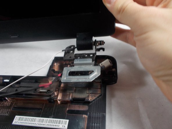

    • Lift the bottom right side of the screen to move the metal plate covering the power jack.

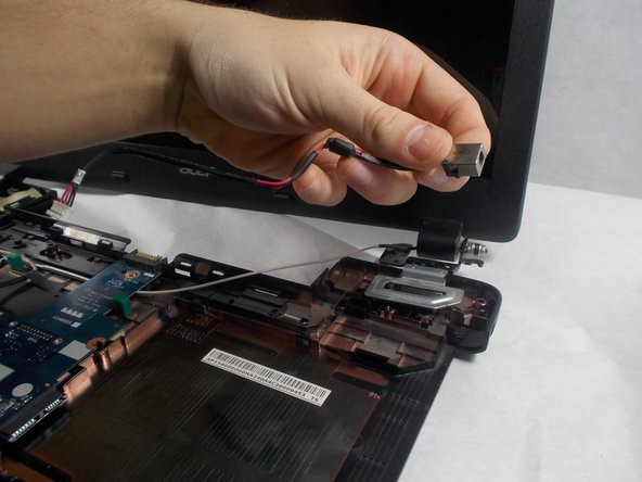

  8. Acer Aspire E5-571-58CG Power Jack Replacement: crwdns2935265:08crwdnd2935265:01crwdnd2935265:02crwdne2935265:0 Acer Aspire E5-571-58CG Power Jack Replacement: crwdns2935265:08crwdnd2935265:02crwdnd2935265:02crwdne2935265:0
    • Carefully lift the power jack out of the laptop.
