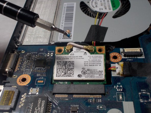

    • Use a JIS #000 screw bit to remove the marked screw.
  5. Acer Aspire E5-571-58CG CPU Fan Replacement: crwdns2935265:05crwdnd2935265:01crwdnd2935265:02crwdne2935265:0 Acer Aspire E5-571-58CG CPU Fan Replacement: crwdns2935265:05crwdnd2935265:02crwdnd2935265:02crwdne2935265:0

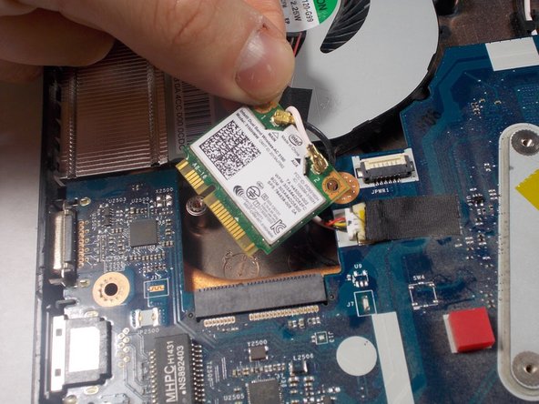

    • Carefully pull the marked green chip out of the motherboard.
  6. Acer Aspire E5-571-58CG CPU Fan Replacement: crwdns2935265:06crwdnd2935265:01crwdnd2935265:02crwdne2935265:0 Acer Aspire E5-571-58CG CPU Fan Replacement: crwdns2935265:06crwdnd2935265:02crwdnd2935265:02crwdne2935265:0
