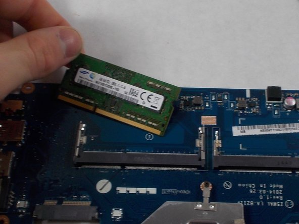

    • Remove the board from the laptop body, flip over for access to the ram
  15. Acer Aspire E5-511p-C6US RAM Replacement: crwdns2935265:015crwdnd2935265:01crwdnd2935265:02crwdne2935265:0 Acer Aspire E5-511p-C6US RAM Replacement: crwdns2935265:015crwdnd2935265:02crwdnd2935265:02crwdne2935265:0
    • Press down on the spring clips on either side of the ram, It will unlock and can be removed
