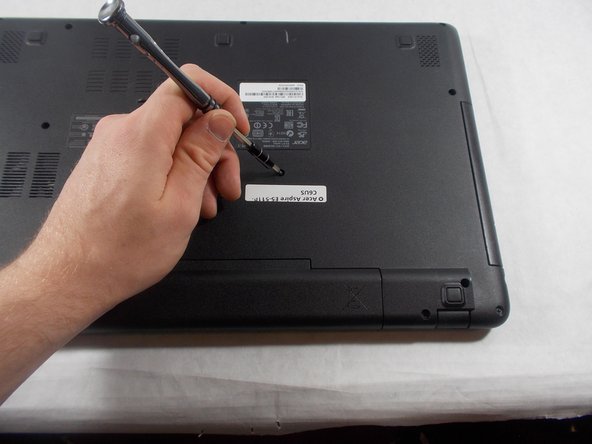

    • On the back of the laptop, there is a sliding lock. Push the slider and the battery will unlock
  2. Acer Aspire E5-511p-C6US Optical Drive Replacement: crwdns2935265:02crwdnd2935265:01crwdnd2935265:01crwdne2935265:0
    • Pull battery to remove.
  3. Acer Aspire E5-511p-C6US Optical Drive Replacement, Optical Drive: crwdns2935265:03crwdnd2935265:01crwdnd2935265:02crwdne2935265:0 Acer Aspire E5-511p-C6US Optical Drive Replacement, Optical Drive: crwdns2935265:03crwdnd2935265:02crwdnd2935265:02crwdne2935265:0
    • Remove the 1 screw just above the battery with a Phillips #1 screwdriver.

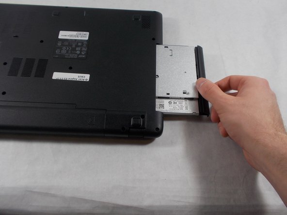

  4. Acer Aspire E5-511p-C6US Optical Drive Replacement: crwdns2935265:04crwdnd2935265:01crwdnd2935265:02crwdne2935265:0 Acer Aspire E5-511p-C6US Optical Drive Replacement: crwdns2935265:04crwdnd2935265:02crwdnd2935265:02crwdne2935265:0
    • Pull the Optical Drive out
