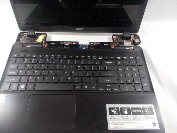

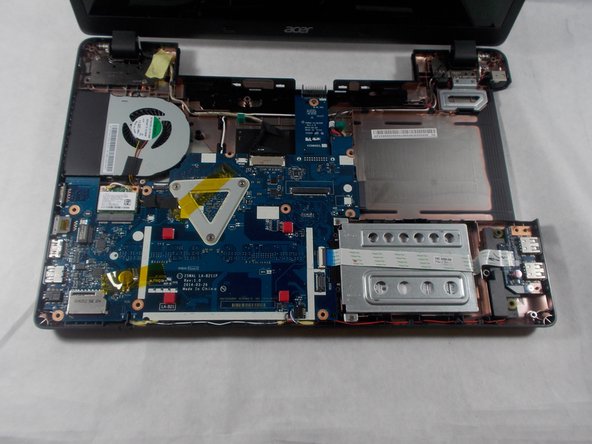

    • Flip over the laptop, Using the spudger separate the body of the keyboard from the base of the laptop.
  7. Acer Aspire E5-511p-C6US Keyboard Replacement: crwdns2935265:07crwdnd2935265:01crwdnd2935265:02crwdne2935265:0 Acer Aspire E5-511p-C6US Keyboard Replacement: crwdns2935265:07crwdnd2935265:02crwdnd2935265:02crwdne2935265:0
    • Carefully lift the keyboard and disconnect the 3 ribbon style connectors from the computers boards.
