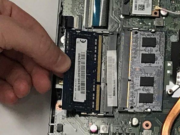

  4. Acer Aspire E5-471-5456 Ram Replacement, RAM: crwdns2935265:04crwdnd2935265:01crwdnd2935265:02crwdne2935265:0 Acer Aspire E5-471-5456 Ram Replacement, RAM: crwdns2935265:04crwdnd2935265:02crwdnd2935265:02crwdne2935265:0
    • Locate the two RAM cards.
    • Each RAM card will be held in place by two clips located on the left and right sides of each card. Simply pop both clips out at the same time and remove the RAM with your hand.
    • Repeat the process with the second RAM card.
    • Be careful when removing to avoid bumping other parts.
