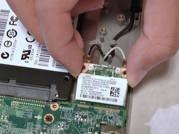

  7. Acer Aspire E3-111-C0WA RAM Replacement, Wireless Card: crwdns2935265:07crwdnd2935265:01crwdnd2935265:02crwdne2935265:0 Acer Aspire E3-111-C0WA RAM Replacement, Wireless Card: crwdns2935265:07crwdnd2935265:02crwdnd2935265:02crwdne2935265:0

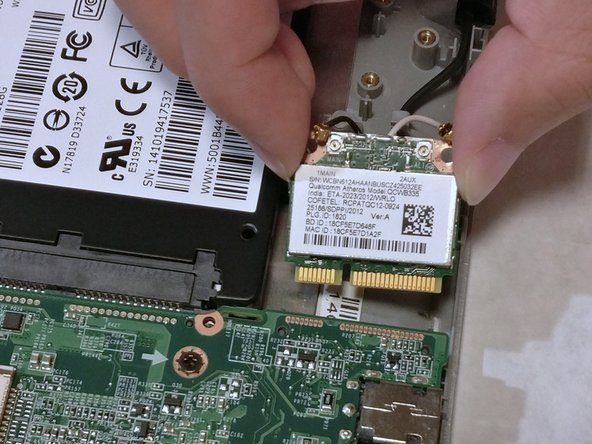

    • Remove the two antenna cables from the wireless card. These should snap lightly out of place when lifted upwards.
  8. Acer Aspire E3-111-C0WA RAM Replacement: crwdns2935265:08crwdnd2935265:01crwdnd2935265:03crwdne2935265:0 Acer Aspire E3-111-C0WA RAM Replacement: crwdns2935265:08crwdnd2935265:02crwdnd2935265:03crwdne2935265:0 Acer Aspire E3-111-C0WA RAM Replacement: crwdns2935265:08crwdnd2935265:03crwdnd2935265:03crwdne2935265:0
    • Remove the 6.2mm #1 Phillips head screw attaching the wireless card to the case.
    • Pull the wireless card horizontally away from the motherboard to remove it from the connector.

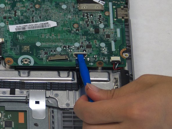

    • Lightly pry upwards on the black plastic tab to release the touchpad cable, then gently pull the cable from the connector.
  11. Acer Aspire E3-111-C0WA RAM Replacement: crwdns2935265:011crwdnd2935265:01crwdnd2935265:03crwdne2935265:0 Acer Aspire E3-111-C0WA RAM Replacement: crwdns2935265:011crwdnd2935265:02crwdnd2935265:03crwdne2935265:0 Acer Aspire E3-111-C0WA RAM Replacement: crwdns2935265:011crwdnd2935265:03crwdnd2935265:03crwdne2935265:0

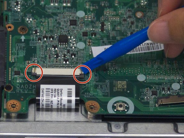

    • Find the keyboard cable. Pull the two gray plastic tabs outwards to release the ribbon. Gently pull the cable from the connector.

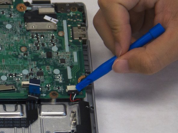

    • Pull down gently on the black speaker cable connector to disconnect it from the motherboard.

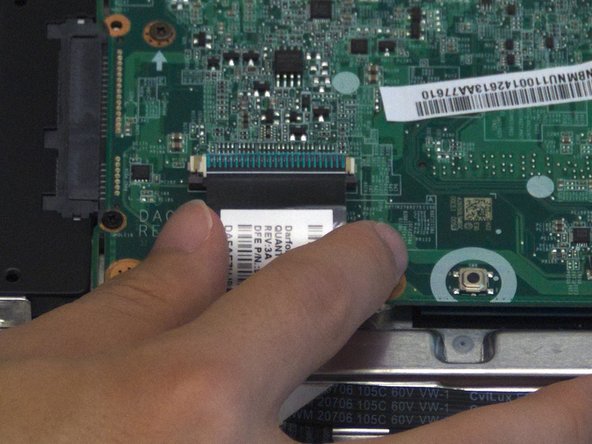

    • Peel up the tape adhering the display cable to the connector on the motherboard.
    • Slide the display cable horizontally out of the connector to remove it from the motherboard.

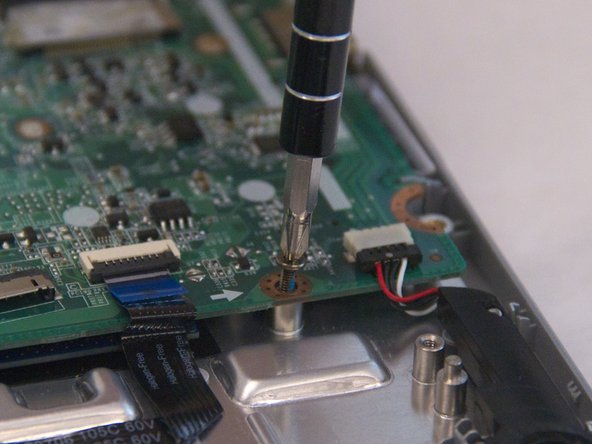

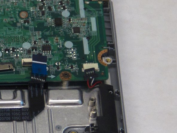

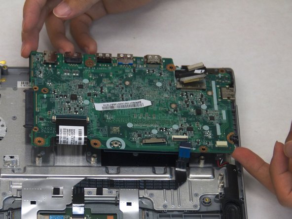

  14. Acer Aspire E3-111-C0WA RAM Replacement: crwdns2935265:014crwdnd2935265:01crwdnd2935265:03crwdne2935265:0 Acer Aspire E3-111-C0WA RAM Replacement: crwdns2935265:014crwdnd2935265:02crwdnd2935265:03crwdne2935265:0 Acer Aspire E3-111-C0WA RAM Replacement: crwdns2935265:014crwdnd2935265:03crwdnd2935265:03crwdne2935265:0
    • Unscrew the four 6.2mm Phillips #1 screws attaching the motherboard to the case.
    • With all the screws and cables detached, lift the motherboard directly upwards out of the case.

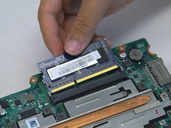

    • Flip over the motherboard after removing it from the case.
    • Apply pressure outward on the metal tabs on either side of the RAM stick to release them from the notches on the stick.
    • The RAM stick may be under some tension and potentially fly out of the socket if not held in place as the tabs are released.
    • After the tabs have been released, slide the RAM out of the slot.
