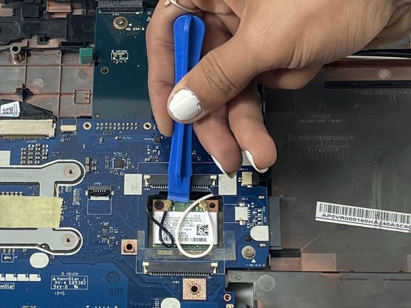

  8. Acer Aspire E1-572-6829 Speakers Replacement, Wi-Fi Card: crwdns2935265:08crwdnd2935265:01crwdnd2935265:02crwdne2935265:0 Acer Aspire E1-572-6829 Speakers Replacement, Wi-Fi Card: crwdns2935265:08crwdnd2935265:02crwdnd2935265:02crwdne2935265:0
    • Detach the two cables connected to the Wi-Fi card. Gently pull them off using a plastic pry tool or your fingers.
    • To reinsert the cables, push them back onto the connecting points. Make sure that you orient them on the same side you disconnected them from.

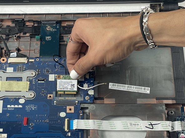

  9. Acer Aspire E1-572-6829 Speakers Replacement: crwdns2935265:09crwdnd2935265:01crwdnd2935265:02crwdne2935265:0 Acer Aspire E1-572-6829 Speakers Replacement: crwdns2935265:09crwdnd2935265:02crwdnd2935265:02crwdne2935265:0
    • Unscrew and remove the one 5 mm Phillips #0 screw that secures the Wi-Fi card.
    • Carefully lift up the Wi-Fi card and pull it up and out to remove it.

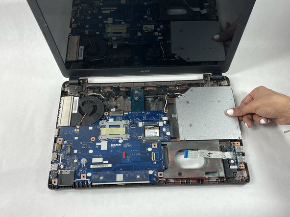

  10. Acer Aspire E1-572-6829 Speakers Replacement, Speakers: crwdns2935265:010crwdnd2935265:01crwdnd2935265:02crwdne2935265:0 Acer Aspire E1-572-6829 Speakers Replacement, Speakers: crwdns2935265:010crwdnd2935265:02crwdnd2935265:02crwdne2935265:0
    • Use a Phillips #0 screwdriver to remove the eleven 5 mm screws that secure the motherboard.
    • Slide out the optical disk drive to the right side to remove it.

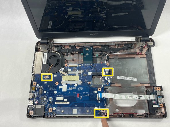

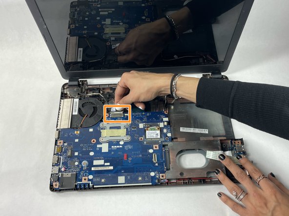

  11. Acer Aspire E1-572-6829 Speakers Replacement: crwdns2935265:011crwdnd2935265:01crwdnd2935265:03crwdne2935265:0 Acer Aspire E1-572-6829 Speakers Replacement: crwdns2935265:011crwdnd2935265:02crwdnd2935265:03crwdne2935265:0 Acer Aspire E1-572-6829 Speakers Replacement: crwdns2935265:011crwdnd2935265:03crwdnd2935265:03crwdne2935265:0
    • Unplug the ZIF connector by using a plastic spudger or your finger to lift the locking flap before gently pulling it out.
    • Use a plastic spudger or your fingers to flip the metal clip over and then gently pull the display cable connector out.
    • Unplug the no-fuss ribbon cables by pulling them straight out of the connector using your fingers.
    • Check out this page for more information on these types of connectors.

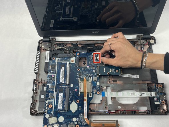

  12. Acer Aspire E1-572-6829 Speakers Replacement: crwdns2935265:012crwdnd2935265:01crwdnd2935265:02crwdne2935265:0 Acer Aspire E1-572-6829 Speakers Replacement: crwdns2935265:012crwdnd2935265:02crwdnd2935265:02crwdne2935265:0
    • Carefully lift the motherboard up from the bottom edge and slide it down to dislodge it from the case.
    • Carefully flip the motherboard over.
    • Unplug the connector on the bottom of the motherboard by using your fingers to gently pull it out.
    • The motherboard can now be safely removed from the laptop.

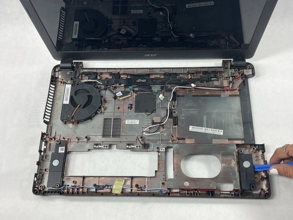

  13. Acer Aspire E1-572-6829 Speakers Replacement: crwdns2935265:013crwdnd2935265:01crwdnd2935265:03crwdne2935265:0 Acer Aspire E1-572-6829 Speakers Replacement: crwdns2935265:013crwdnd2935265:02crwdnd2935265:03crwdne2935265:0 Acer Aspire E1-572-6829 Speakers Replacement: crwdns2935265:013crwdnd2935265:03crwdnd2935265:03crwdne2935265:0
    • Unscrew the 5 mm Phillips #0 screw holding down the USB daughterboard and remove the board from the case.
    • Use a plastic spudger to pry the speakers free from the laptop case.
    • Pay attention to the speaker wires that are routed under some tabs at the bottom of the laptop case.
