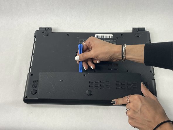

    • Remove the 8 mm screw holding down the lower back panel using a Phillips #0 screwdriver.
    • Use a plastic spudger or a similar tool to pry open the panel from the top edge.
    • Lift up the panel to remove it.

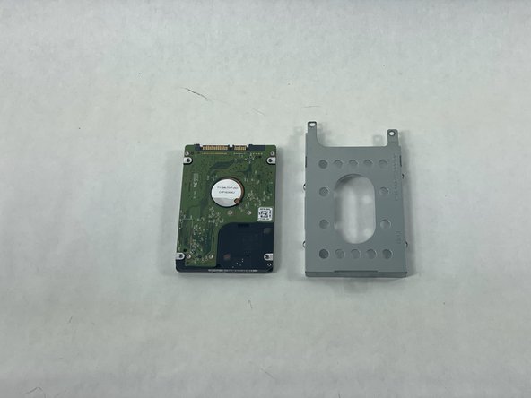

    • Remove the two 8 mm Phillips #0 screws holding the Hard Disk tray.
    • Once both screws are removed, use the tab on the left to slide the hard disk tray out from the SATA port.
    • Once the tray is pulled out to the left, the assembly can safely be removed from the laptop.

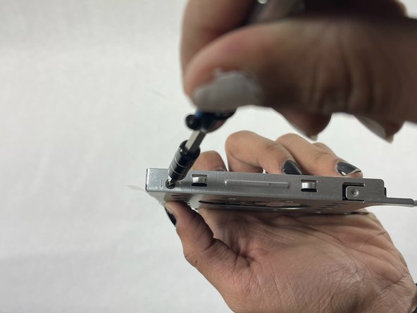

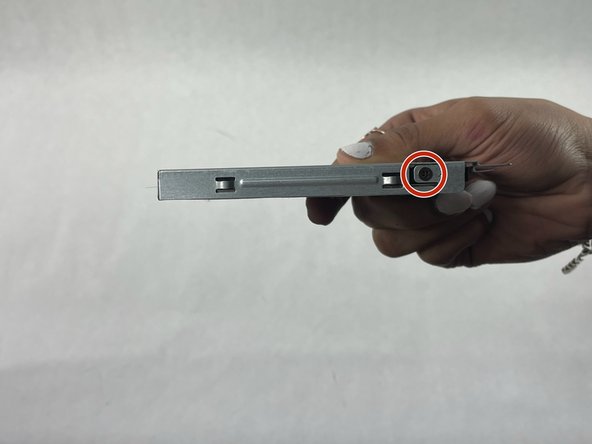

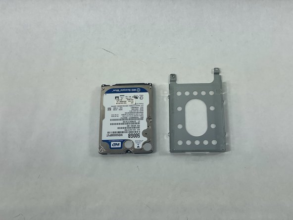

    • Use a Phillips #0 screwdriver to remove the two 2 mm screws (one on each side) attaching the hard disk to the hard disk tray.
  6. Acer Aspire E1-572-6829 Hard Disk Replacement: crwdns2935265:06crwdnd2935265:01crwdnd2935265:03crwdne2935265:0 Acer Aspire E1-572-6829 Hard Disk Replacement: crwdns2935265:06crwdnd2935265:02crwdnd2935265:03crwdne2935265:0 Acer Aspire E1-572-6829 Hard Disk Replacement: crwdns2935265:06crwdnd2935265:03crwdnd2935265:03crwdne2935265:0
    • Once the screws have been removed, the hard disk can be separated from the tray.
