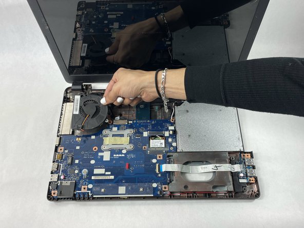

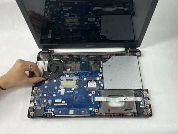

  8. Acer Aspire E1-572-6829 Fan Replacement, Fan: crwdns2935265:08crwdnd2935265:01crwdnd2935265:03crwdne2935265:0 Acer Aspire E1-572-6829 Fan Replacement, Fan: crwdns2935265:08crwdnd2935265:02crwdnd2935265:03crwdne2935265:0 Acer Aspire E1-572-6829 Fan Replacement, Fan: crwdns2935265:08crwdnd2935265:03crwdnd2935265:03crwdne2935265:0
    • Use a Phillips #0 screwdriver to remove the two 5 mm screws on the fan.
    • Unplug the cable connecting the fan to the motherboard.
    • Lift the fan up and out of the laptop.
