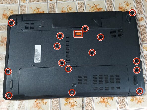

    • Remove all the shown screws, slide out the battery and DVD drive. The screws marked in RED are M3.0x8.0.
    • Remove the Wi-Fi mini PCI card (marked in blue) and the SSD.
    • Remove the screws marked in GREEN (M2.0x3.0) and YELLOW (M2.5x5.0).
    • Here you can upgrade the RAM and SSD before finishing.
    • Use a prying tool to release all the clips and remove the palmrest.
    • In my guide I will NOT be removing the keyboard, because I was able to connect and disconnect the connectors regardless. For you, it may be recommended. There are 3 connectors that need to be unplugged (power switch, mousepad, keyboard).

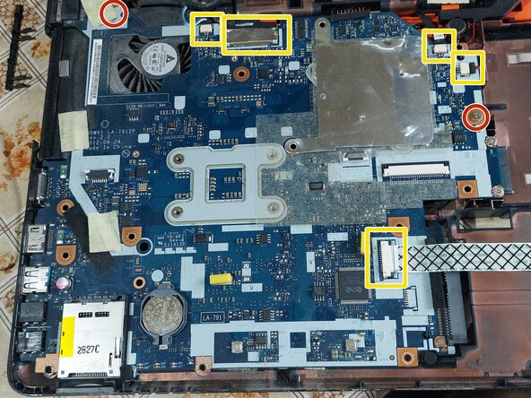

    • Remove the 2 screws that hold the motherboard in place.
    • Disconnect all the marked connectors.
    • Carefully lift the motherboard from the DVD connector, flip it, disconnect the power connector and slide the motherboard out.
