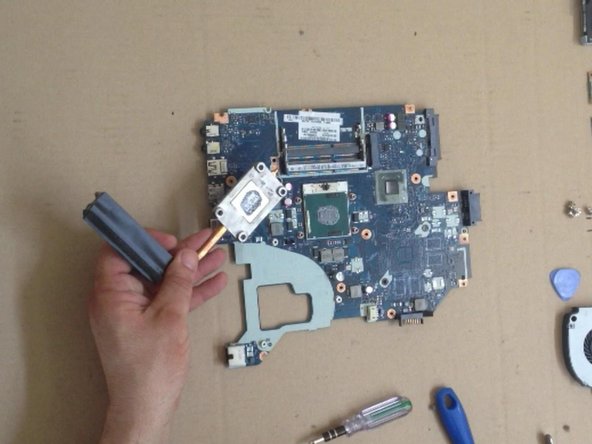

    • Remove the heat sink system.
    • Careful remove the old thermal patse from the Processor and from the Head-sync system.

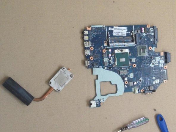

  12. Acer Aspire E1-571 - Heat Sink Cleaning, Thermal Paste Replacing: crwdns2935265:012crwdnd2935265:01crwdnd2935265:03crwdne2935265:0 Acer Aspire E1-571 - Heat Sink Cleaning, Thermal Paste Replacing: crwdns2935265:012crwdnd2935265:02crwdnd2935265:03crwdne2935265:0 Acer Aspire E1-571 - Heat Sink Cleaning, Thermal Paste Replacing: crwdns2935265:012crwdnd2935265:03crwdnd2935265:03crwdne2935265:0
    • Put a new thermal paste. Cover the entire surface of the CPU crystal.
    • Install the Heat-sync system and screw the screws at a few steps.
