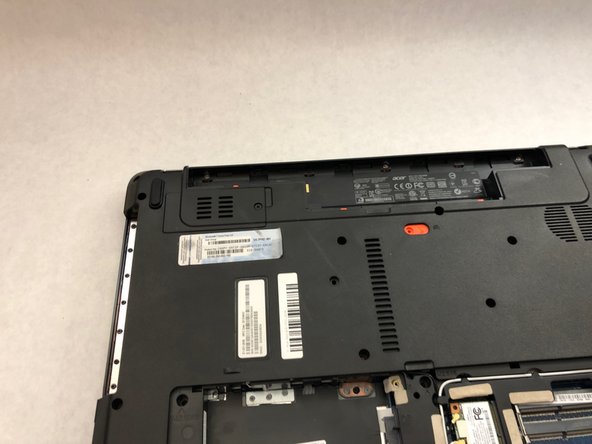

    • Unplug and power down the device before removing the battery.
    • Turn the device over so the back side is facing up.
    • Using a spudger, slide the orange latch to the right. This will release the battery, which should pop up from the device.
    • Use two hands tilt the side of the battery closest to the orange latch upward as shown in the images.

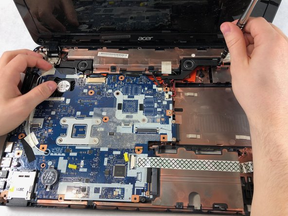

    • Using a spudger, disconnect the connector for the left speaker.
    • Disconnect the right speaker connector in the same manner.
  12. Acer Aspire E1-531-2438 Speakers Replacement: crwdns2935265:012crwdnd2935265:01crwdnd2935265:02crwdne2935265:0 Acer Aspire E1-531-2438 Speakers Replacement: crwdns2935265:012crwdnd2935265:02crwdnd2935265:02crwdne2935265:0
    • Using a Phillips #0 screwdriver, remove the four 3mm screws to release the left and right speakers.
  13. Acer Aspire E1-531-2438 Speakers Replacement: crwdns2935265:013crwdnd2935265:01crwdnd2935265:02crwdne2935265:0 Acer Aspire E1-531-2438 Speakers Replacement: crwdns2935265:013crwdnd2935265:02crwdnd2935265:02crwdne2935265:0
    • Lift and remove the left and right speakers.
