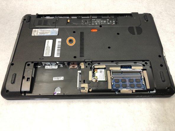

    • Unplug and power down the device before removing the battery.
    • Turn the device over so the back side is facing up.
    • Using a spudger, slide the orange latch to the right. This will release the battery, which should pop up from the device.
    • Use two hands tilt the side of the battery closest to the orange latch upward as shown in the images.
  2. Acer Aspire E1-531-2438 Screen Replacement: crwdns2935265:02crwdnd2935265:01crwdnd2935265:01crwdne2935265:0
    • Tilt the side of the battery closest to the orange latch upward.
    • Lift the battery up and out of the device.
  3. Acer Aspire E1-531-2438 Screen Replacement, Hard Drive: crwdns2935265:03crwdnd2935265:01crwdnd2935265:02crwdne2935265:0 Acer Aspire E1-531-2438 Screen Replacement, Hard Drive: crwdns2935265:03crwdnd2935265:02crwdnd2935265:02crwdne2935265:0
    • Using a Phillips #0 screwdriver, remove the two 9mm screws on the access panel.
  4. Acer Aspire E1-531-2438 Screen Replacement: crwdns2935265:04crwdnd2935265:01crwdnd2935265:03crwdne2935265:0 Acer Aspire E1-531-2438 Screen Replacement: crwdns2935265:04crwdnd2935265:02crwdnd2935265:03crwdne2935265:0 Acer Aspire E1-531-2438 Screen Replacement: crwdns2935265:04crwdnd2935265:03crwdnd2935265:03crwdne2935265:0
    • Using the indentation, pry open the access panel with your fingers or a spudger.
    • Remove the access panel to expose the hard drive, WiFi chip, and RAM modules.
  5. Acer Aspire E1-531-2438 Screen Replacement: crwdns2935265:05crwdnd2935265:01crwdnd2935265:03crwdne2935265:0 Acer Aspire E1-531-2438 Screen Replacement: crwdns2935265:05crwdnd2935265:02crwdnd2935265:03crwdne2935265:0 Acer Aspire E1-531-2438 Screen Replacement: crwdns2935265:05crwdnd2935265:03crwdnd2935265:03crwdne2935265:0
    • Grip the plastic tab on the hard drive, then pull to the left to unplug the drive from its socket.
    • Once free from the socket, lift the hard drive up and out of the device.
  6. Acer Aspire E1-531-2438 Screen Replacement, Screen: crwdns2935265:06crwdnd2935265:01crwdnd2935265:03crwdne2935265:0 Acer Aspire E1-531-2438 Screen Replacement, Screen: crwdns2935265:06crwdnd2935265:02crwdnd2935265:03crwdne2935265:0 Acer Aspire E1-531-2438 Screen Replacement, Screen: crwdns2935265:06crwdnd2935265:03crwdnd2935265:03crwdne2935265:0

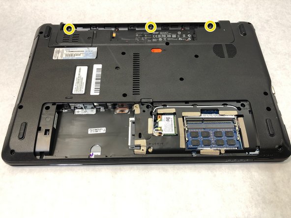

    • Using a Phillips #0 screwdriver, remove all of the following screws:
    • Fifteen 9mm screws
    • One 6mm screw
    • Three 3.5mm screws

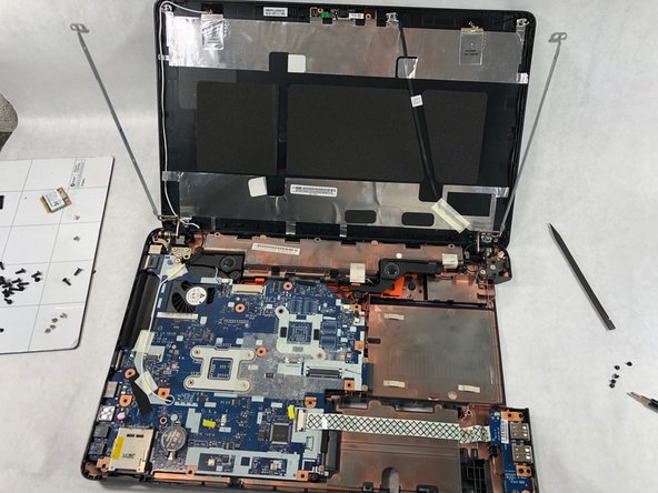

    • Lift and remove the palmrest assembly and the attached keyboard.
  11. Acer Aspire E1-531-2438 Screen Replacement: crwdns2935265:011crwdnd2935265:01crwdnd2935265:01crwdne2935265:0
    • Using two hands, push toward the screen to disconnect the screen connector.
  12. Acer Aspire E1-531-2438 Screen Replacement: crwdns2935265:012crwdnd2935265:01crwdnd2935265:02crwdne2935265:0 Acer Aspire E1-531-2438 Screen Replacement: crwdns2935265:012crwdnd2935265:02crwdnd2935265:02crwdne2935265:0
    • Using a spudger, remove the circular plastic screw cover on the screws on the lower left and right of the screen.
    • Using a Phillips #0 screwdriver, remove the two 3mm screws hidden under the circular plastic screw covers.
  13. Acer Aspire E1-531-2438 Screen Replacement: crwdns2935265:013crwdnd2935265:01crwdnd2935265:03crwdne2935265:0 Acer Aspire E1-531-2438 Screen Replacement: crwdns2935265:013crwdnd2935265:02crwdnd2935265:03crwdne2935265:0 Acer Aspire E1-531-2438 Screen Replacement: crwdns2935265:013crwdnd2935265:03crwdnd2935265:03crwdne2935265:0
    • Using a plastic opening tool, go around the edge of the display to remove the plastic bezel.
  14. Acer Aspire E1-531-2438 Screen Replacement: crwdns2935265:014crwdnd2935265:01crwdnd2935265:02crwdne2935265:0 Acer Aspire E1-531-2438 Screen Replacement: crwdns2935265:014crwdnd2935265:02crwdnd2935265:02crwdne2935265:0
    • Using a Phillips #0 screwdriver, remove the three screws in the mounting bracket along the right edge of the screen.
    • Remove the three screws in the mounting bracket along the left edge of the screen in the same manner.
    • Lift the screen out of the device.
