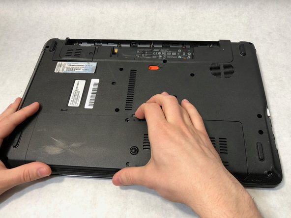

    • Unplug and power down the device before removing the battery.
    • Turn the device over so the back side is facing up.
    • Using a spudger, slide the orange latch to the right. This will release the battery, which should pop up from the device.
    • Use two hands tilt the side of the battery closest to the orange latch upward as shown in the images.
  2. Acer Aspire E1-531-2438 RAM Replacement: crwdns2935265:02crwdnd2935265:01crwdnd2935265:01crwdne2935265:0
    • Tilt the side of the battery closest to the orange latch upward.
    • Lift the battery up and out of the device.
  3. Acer Aspire E1-531-2438 RAM Replacement, RAM: crwdns2935265:03crwdnd2935265:01crwdnd2935265:03crwdne2935265:0 Acer Aspire E1-531-2438 RAM Replacement, RAM: crwdns2935265:03crwdnd2935265:02crwdnd2935265:03crwdne2935265:0 Acer Aspire E1-531-2438 RAM Replacement, RAM: crwdns2935265:03crwdnd2935265:03crwdnd2935265:03crwdne2935265:0
    • Using a Phillips #0 screwdriver, remove the two 9mm screws on the access panel.
    • Remove the access panel to expose the hard drive, WiFi chip, and RAM modules.
  4. Acer Aspire E1-531-2438 RAM Replacement: crwdns2935265:04crwdnd2935265:01crwdnd2935265:03crwdne2935265:0 Acer Aspire E1-531-2438 RAM Replacement: crwdns2935265:04crwdnd2935265:02crwdnd2935265:03crwdne2935265:0 Acer Aspire E1-531-2438 RAM Replacement: crwdns2935265:04crwdnd2935265:03crwdnd2935265:03crwdne2935265:0
    • Gently press outward on the two tabs that lock the RAM module in place.
    • Once the RAM module releases and flips up, gently pull the RAM module directly out of its socket.
