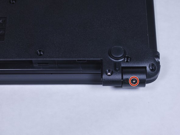

  3. Acer Aspire E1-510P-4637 Touch Screen Display Replacement, Touch Screen Display: crwdns2935265:03crwdnd2935265:01crwdnd2935265:03crwdne2935265:0 Acer Aspire E1-510P-4637 Touch Screen Display Replacement, Touch Screen Display: crwdns2935265:03crwdnd2935265:02crwdnd2935265:03crwdne2935265:0 Acer Aspire E1-510P-4637 Touch Screen Display Replacement, Touch Screen Display: crwdns2935265:03crwdnd2935265:03crwdnd2935265:03crwdne2935265:0

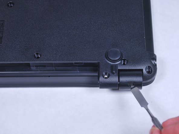

    • Remove the plastic screw covers located near the laptop's hinge using a metal spudger.
    • Remove the two M2.5x8 screws highlighted in the picture with a PH0 Phillips screwdriver.

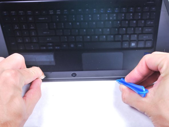

  4. Acer Aspire E1-510P-4637 Touch Screen Display Replacement: crwdns2935265:04crwdnd2935265:01crwdnd2935265:03crwdne2935265:0 Acer Aspire E1-510P-4637 Touch Screen Display Replacement: crwdns2935265:04crwdnd2935265:02crwdnd2935265:03crwdne2935265:0 Acer Aspire E1-510P-4637 Touch Screen Display Replacement: crwdns2935265:04crwdnd2935265:03crwdnd2935265:03crwdne2935265:0
    • Flip the laptop over and open it up so the screen is facing up and the top of the screen is facing you.
    • Use a plastic opening tool to separate the the touchscreen from the back cover.
    • Carefully work your way around the frame and gently pry. Be careful not to brake the frame or damage the screen.

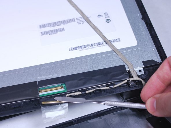

  5. Acer Aspire E1-510P-4637 Touch Screen Display Replacement: crwdns2935265:05crwdnd2935265:01crwdnd2935265:03crwdne2935265:0 Acer Aspire E1-510P-4637 Touch Screen Display Replacement: crwdns2935265:05crwdnd2935265:02crwdnd2935265:03crwdne2935265:0 Acer Aspire E1-510P-4637 Touch Screen Display Replacement: crwdns2935265:05crwdnd2935265:03crwdnd2935265:03crwdne2935265:0

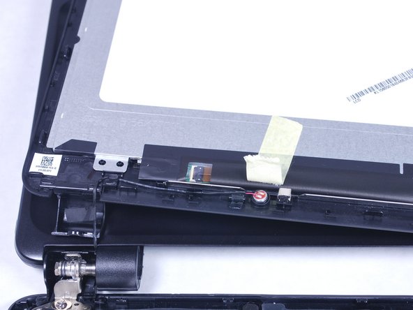

    • Disconnect the display cable by first taking off the tape using a metal spudger and then pulling on the black tab.
  6. Acer Aspire E1-510P-4637 Touch Screen Display Replacement: crwdns2935265:06crwdnd2935265:01crwdnd2935265:02crwdne2935265:0 Acer Aspire E1-510P-4637 Touch Screen Display Replacement: crwdns2935265:06crwdnd2935265:02crwdnd2935265:02crwdne2935265:0

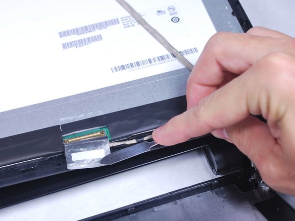

    • Take off the yellow tape connecting the display to the border.

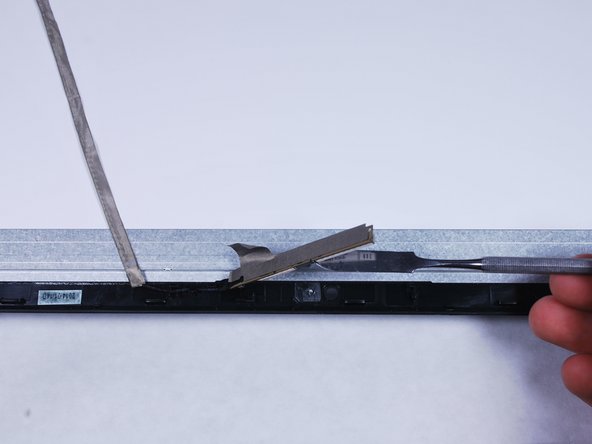

  7. Acer Aspire E1-510P-4637 Touch Screen Display Replacement: crwdns2935265:07crwdnd2935265:01crwdnd2935265:02crwdne2935265:0 Acer Aspire E1-510P-4637 Touch Screen Display Replacement: crwdns2935265:07crwdnd2935265:02crwdnd2935265:02crwdne2935265:0
    • Pull back the adhesive using the metal spudger.
    • Pry out the camera by lifting the adhesive with the metal spudger. Then, remove the camera by lifting it up by one side.

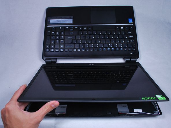

  9. Acer Aspire E1-510P-4637 Touch Screen Display Replacement: crwdns2935265:09crwdnd2935265:01crwdnd2935265:01crwdne2935265:0
    • Release the display from the border using your hands.
