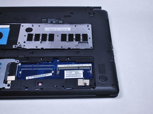

  3. Acer Aspire E1-510P-4637 RAM Replacement, RAM: crwdns2935265:03crwdnd2935265:01crwdnd2935265:01crwdne2935265:0
    • Remove the M2.5x8 screw with a PH1 screwdriver.
  4. Acer Aspire E1-510P-4637 RAM Replacement: crwdns2935265:04crwdnd2935265:01crwdnd2935265:01crwdne2935265:0
    • Use the plastic opening tool to pop up off the back cover.

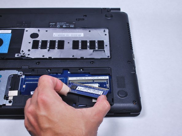

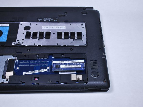

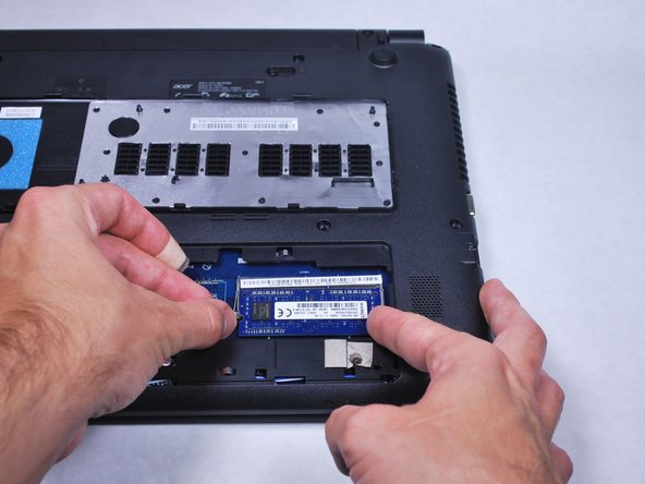

  5. Acer Aspire E1-510P-4637 RAM Replacement: crwdns2935265:05crwdnd2935265:01crwdnd2935265:03crwdne2935265:0 Acer Aspire E1-510P-4637 RAM Replacement: crwdns2935265:05crwdnd2935265:02crwdnd2935265:03crwdne2935265:0 Acer Aspire E1-510P-4637 RAM Replacement: crwdns2935265:05crwdnd2935265:03crwdnd2935265:03crwdne2935265:0
    • Use your fingers to pinch the retaining latch. This will free the RAM.
  6. Acer Aspire E1-510P-4637 RAM Replacement: crwdns2935265:06crwdnd2935265:01crwdnd2935265:03crwdne2935265:0 Acer Aspire E1-510P-4637 RAM Replacement: crwdns2935265:06crwdnd2935265:02crwdnd2935265:03crwdne2935265:0 Acer Aspire E1-510P-4637 RAM Replacement: crwdns2935265:06crwdnd2935265:03crwdnd2935265:03crwdne2935265:0
    • Rotate the RAM sticks up and slide the RAM out.
