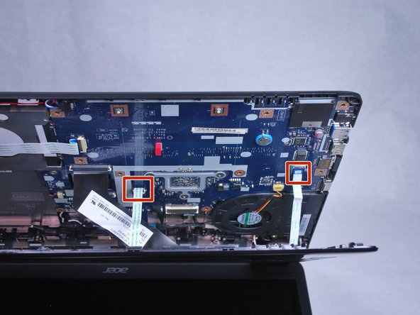

  11. Acer Aspire E1-510P-4637 Keyboard Replacement: crwdns2935265:011crwdnd2935265:01crwdnd2935265:03crwdne2935265:0 Acer Aspire E1-510P-4637 Keyboard Replacement: crwdns2935265:011crwdnd2935265:02crwdnd2935265:03crwdne2935265:0 Acer Aspire E1-510P-4637 Keyboard Replacement: crwdns2935265:011crwdnd2935265:03crwdnd2935265:03crwdne2935265:0
    • Rotate the back cover up a little to reveal the cables connected to the motherboard.
    • Unplug the cables by sliding them out of their receptacle.
    • The connectors are very small and fragile. Handle with care.

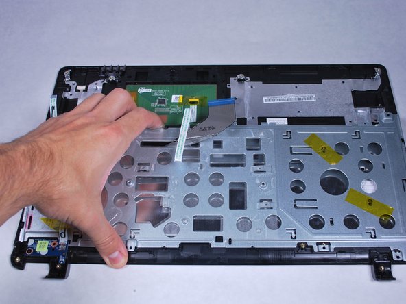

  12. Acer Aspire E1-510P-4637 Keyboard Replacement: crwdns2935265:012crwdnd2935265:01crwdnd2935265:01crwdne2935265:0
    • Remove the four center panel M1.6x3 screws with a PH0 Phillips screwdriver.
    • Remove the two M2x3 screws with a PH0 Phillips screwdriver.

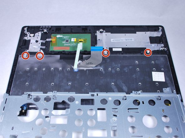

  13. Acer Aspire E1-510P-4637 Keyboard Replacement: crwdns2935265:013crwdnd2935265:01crwdnd2935265:03crwdne2935265:0 Acer Aspire E1-510P-4637 Keyboard Replacement: crwdns2935265:013crwdnd2935265:02crwdnd2935265:03crwdne2935265:0 Acer Aspire E1-510P-4637 Keyboard Replacement: crwdns2935265:013crwdnd2935265:03crwdnd2935265:03crwdne2935265:0
    • Use the plastic opening tool to slide the metal part out to release it from the retaining tabs.

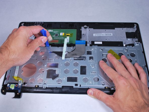

  14. Acer Aspire E1-510P-4637 Keyboard Replacement: crwdns2935265:014crwdnd2935265:01crwdnd2935265:02crwdne2935265:0 Acer Aspire E1-510P-4637 Keyboard Replacement: crwdns2935265:014crwdnd2935265:02crwdnd2935265:02crwdne2935265:0
    • Peel off the foil adhesive stuck to the keyboard.
  15. Acer Aspire E1-510P-4637 Keyboard Replacement: crwdns2935265:015crwdnd2935265:01crwdnd2935265:01crwdne2935265:0
    • Remove the keyboard.
