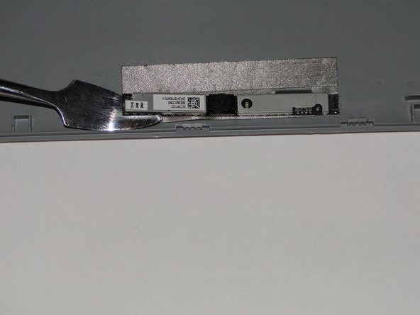

  11. Acer Aspire E1-510-2500 Webcam Replacement, Webcam: crwdns2935265:011crwdnd2935265:01crwdnd2935265:02crwdne2935265:0 Acer Aspire E1-510-2500 Webcam Replacement, Webcam: crwdns2935265:011crwdnd2935265:02crwdnd2935265:02crwdne2935265:0
    • Carefully detach the camera from the back bezel using a spudger and careful upward pressure.
    • Glue is required to reattach the camera to the frame.
