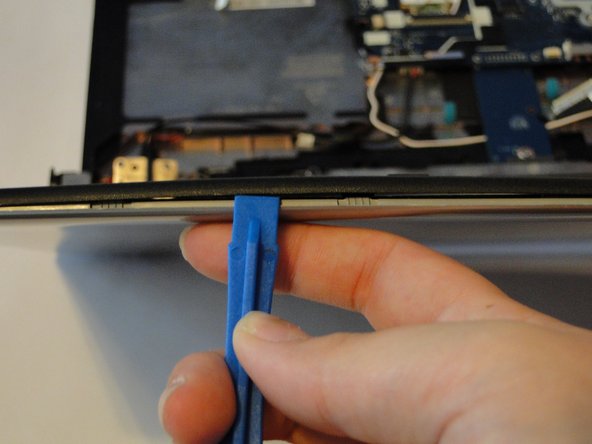

    • Using a plastic opening tool, carefully separate the frame along the edges of the laptop. This should separate the keyboard assembly from the bottom portion of the laptop.

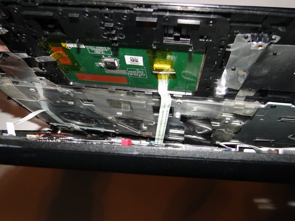

    • Carefully pull the keyboard assembly out away from the base of the laptop. There should be three connections visible in the gap between the keyboard assembly and the base.
    • Using tweezers, carefully detach the connections from the base.

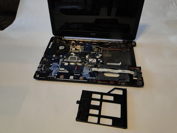

    • Place the keyboard assembly and disk tray place holder aside.
    • For reassembly, leave the disk tray place holder out until after the blue tape connector has been reconnected, to have enough space to reattach the tape.

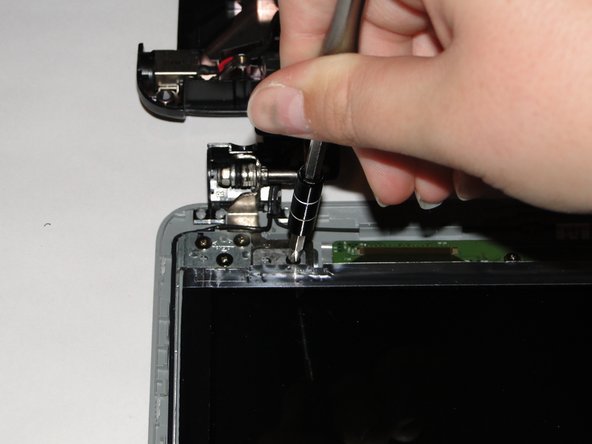

    • Locate the backs of the hinges and remove the two 4mm screws using a Phillips 1 screwdriver. If this is the first time removing these screws, there will be a black covering over each screw. The black covering can be removed with a pair of tweezers.
    • Lay the laptop base down with the screen still open.
    • Detach the wire connection from the screen to the motherboard.
    • Using a plastic opening tool, carefully separate the front bezel from the top case.

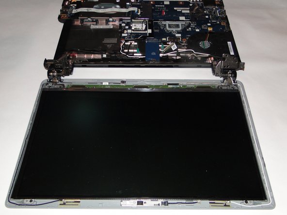

    • Carefully move the wire attached to the screen out of the hinge.
    • Remove the screen.
    • Be careful of the LED attached at the base of the screen because it is not immediately noticeable and can be easily damaged.
